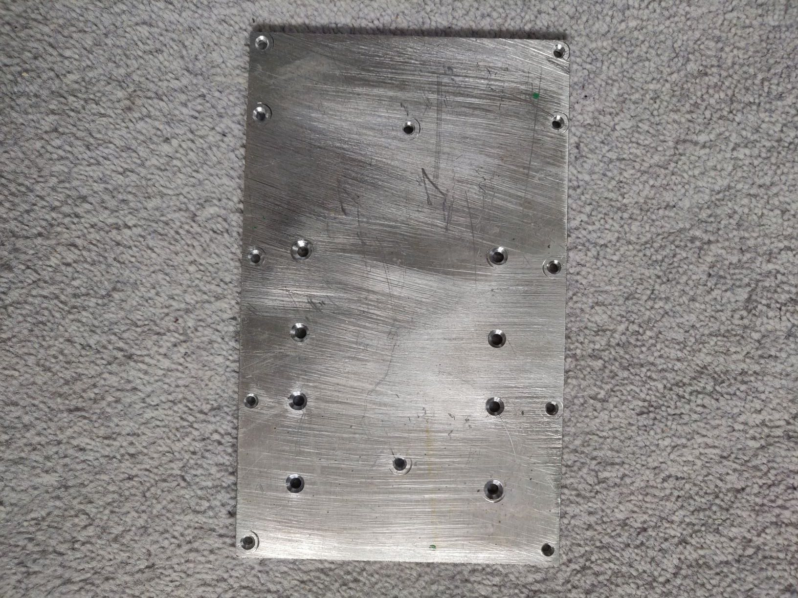

Yes I have tried various settings. I have attached a slightly modified test prog
link to vid and pic. photos.app.goo.gl/VBYt32bv5eShEe6E6
It will do the first pierce but not the other 3. I noticed the arc goes up to 250V on the last three.
Also the code use tool 2 and it picks that from the tools from PlasmaC
It does the same for both files.

The $2 is spindle #2, not tool #2. That is the correct spindle for spotting
It may be that your machine needs a bit of recovery time between torch on signals. Try putting a dwell (G4L between the spots.
Edit: (G4) not G4L, stupid phone...

Ok I have tried a dwell of 4 secs. It is still the same. Then I tried a bolt hole 5Number 40mm dia from the extras. That worked perfectly But then that is using a different tool.

Do you mean that you spotted with the bolt circle or did a cut?

Sorry I should have said the bolt hole cut 5 5mm holes not spotted

I seem to recall similar voltage issues when you were setting your machine up which required using a relay for arc ok. Maybe you machine is not suitable for the way we have spotting set up.
It may be possible to change spotting a bit by adding a value of -1 to the threshold which would mean start the delay when arc ok is established. If you are interested in this let me know and I will have a look tomorrow. This may be a bit heavy handed for spotting but then again it may suit your machine.

Phill I have managed to do what I wanted ie make a back plate to hold a 7i76e all done on the plasma drilling all the holes and cutting it out in one go
All I had to do was stick a 3mm drill through each plasma hole
I changed M3 $2 S1 (cut start) to M3 $0 S1 (cut start) through the file
