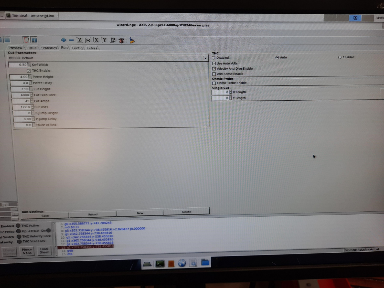

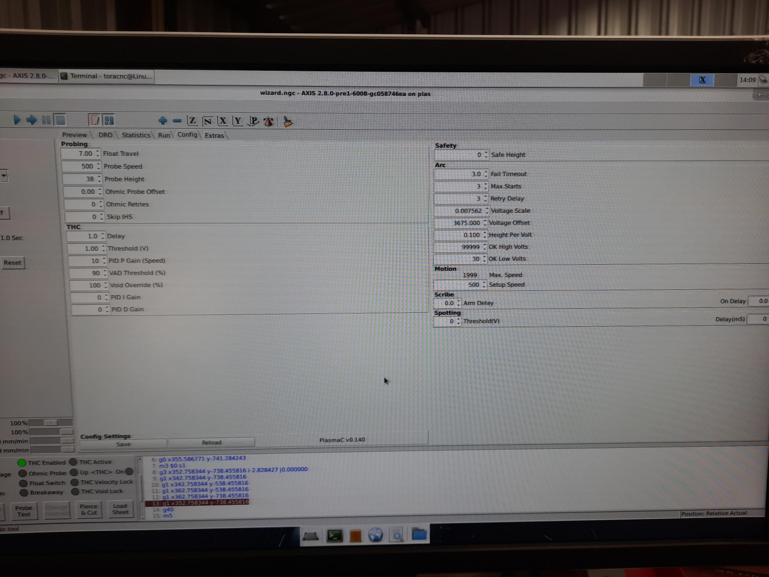

The Voltage Offset on the Config Panel seems to be odd if you are using a THCAD.

13 Aug 2020 08:26 #178086
by luftlupus
Replied by luftlupus on topic Mesa Thcad-10 as the THC?
my offset should be 3,675.0000 which shows in the files but not in the panel.The Voltage Offset on the Config Panel seems to be odd if you are using a THCAD.

13 Aug 2020 08:31 - 13 Aug 2020 08:33 #178087
by phillc54
Replied by phillc54 on topic Mesa Thcad-10 as the THC?
What happens if you enter 3675.00 in there, press the Save button then the Reload button.
I see that the Save button doesn't appear on your Config Panel. Edit your ini file and change [PLASMAC] FONT to a smaller font size.

- luftlupus
- Posts: 84
- Thank you received: 16
13 Aug 2020 08:51 #178088
by luftlupus
So would the offset missing be causing it not to move at all?
Ill give these things a try tomorrow afternoon when i get a chance. Thanks
Edit: the other option would be to get rid of the panel at the bottom of the screen.

When you are cutting note what the THC leds at the bottom do.
Edit. Your cut is a 50mm circle, so around 158mm. You have a THC delay of 1.5 seconds which starts when velocity is 99.9% of cut velocity which is 4000mm/min (67mm/sec) so you cut will almost be complete by the time THC is activated.

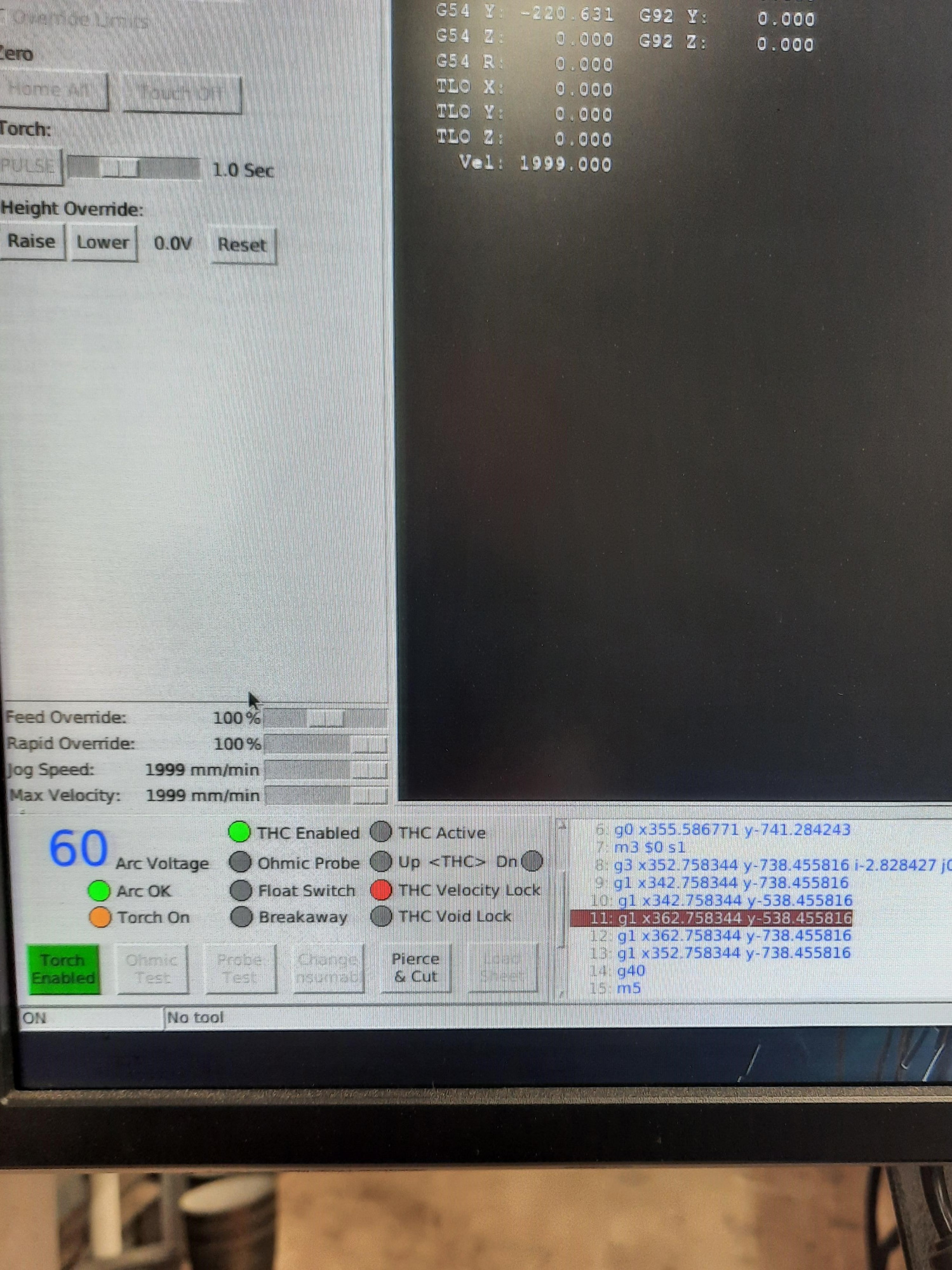

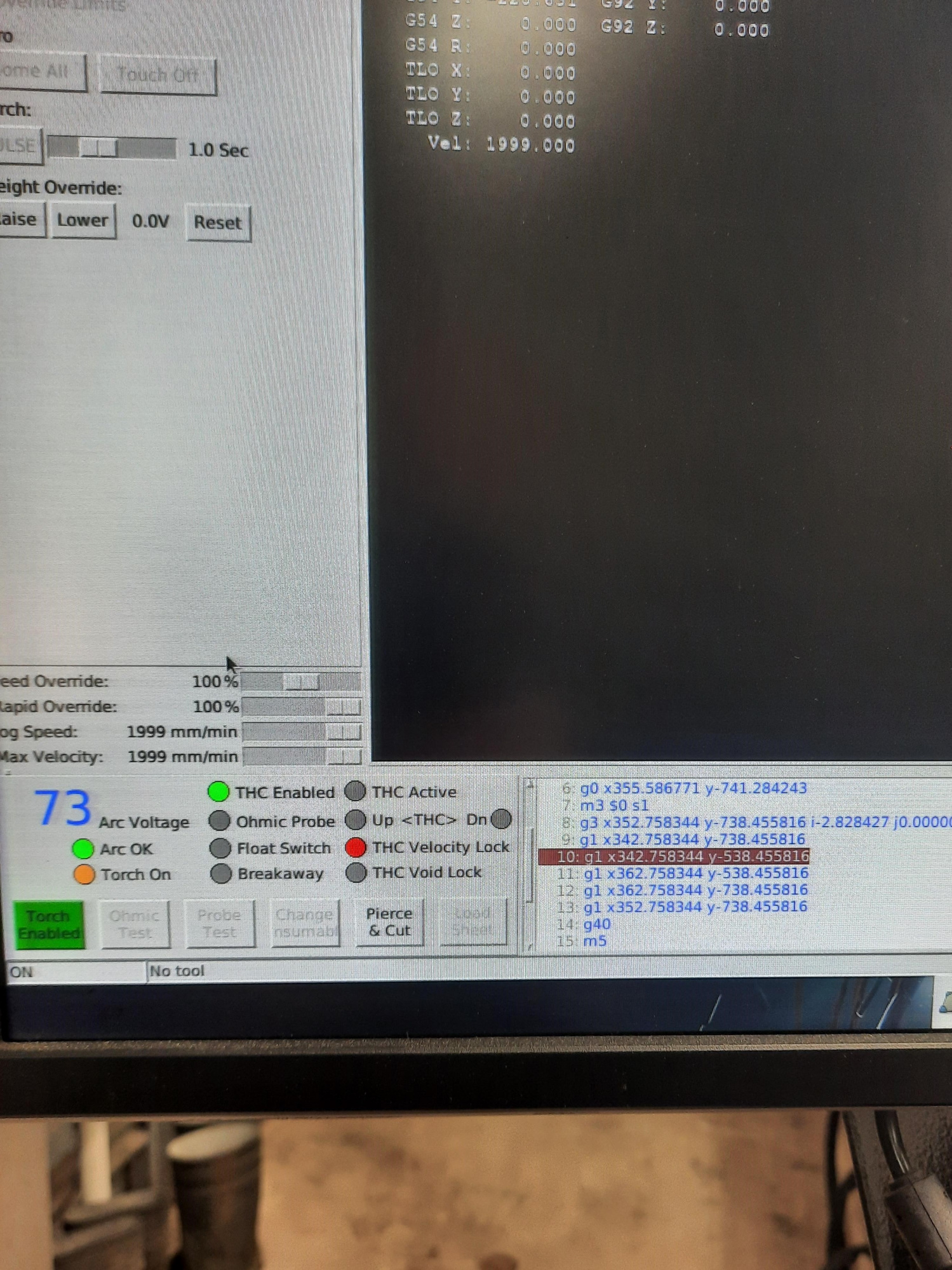

14 Aug 2020 04:47 #178152
by phillc54
Notice on the second pic that THC Velocity Lock is on. This means the machine is not running at the velocity the G-Code file requested. I see that is shows as being 1999 mm/min.

14 Aug 2020 04:48 #178153
by luftlupus
so im assuming thc wont run if the machine isnt running gcode speed?
