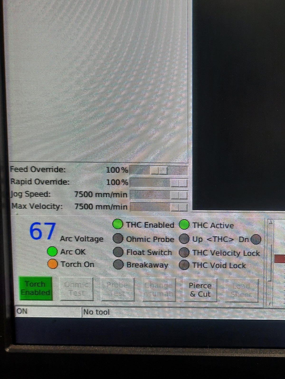

Mesa Thcad-10 as the THC?
- luftlupus
- Posts: 84
- Thank you received: 16
14 Aug 2020 07:35 #178171
by luftlupus
Replied by luftlupus on topic Mesa Thcad-10 as the THC?
- phillc54
- Posts: 5711
- Thank you received: 2100
14 Aug 2020 07:46 #178173
by phillc54
Replied by phillc54 on topic Mesa Thcad-10 as the THC?
Height Per Volt is not used for THC, it is used for on the fly manual height adjustment.
Maybe decrease Pid P Gain.

14 Aug 2020 21:39 #178207
by snowgoer540
I always assumed it was the correction amount the THC was using...
Replied by snowgoer540 on topic Mesa Thcad-10 as the THC?
I actually never knew this... Would it be possible to amend the user guide and the Plasmac Tool Tip to add "when adjusting the height manually using the Height Override"? Or, alternatively it may be better to change the config label from "Height Per Volt" To "Manual Height Override Per Volt".Height Per Volt is not used for THC, it is used for on the fly manual height adjustment.
- phillc54
- Posts: 5711
14 Aug 2020 23:16 #178212
by phillc54
linuxcnc.org/docs/2.8/html/plasma/plasma....html#_control_panel
But I suppose it should be mentioned here as well:
linuxcnc.org/docs/2.8/html/plasma/plasma...de.html#config-panel
The idea of tool tips (to me at) is that they are "tips" and jog the users memory to what they read in the User Guide.
It is mentioned here:
