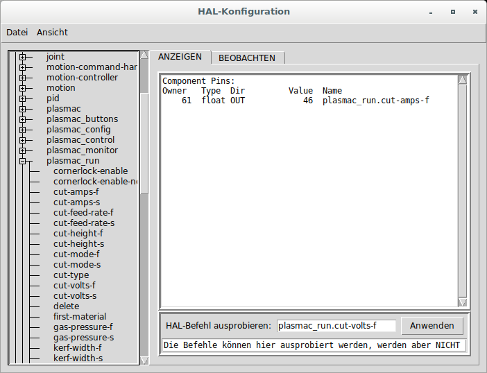

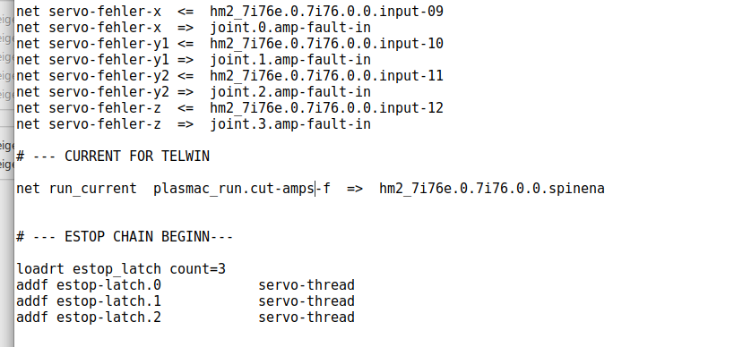

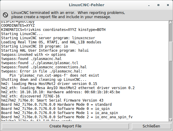

17 Aug 2020 20:15 #178527 by hermann1976
Hello together,
i have a other problem:
the hal command: plasmac_run.cut-amps-f
the connection does not seem to be available (see attachments)
Please can you help?
thanks
17 Aug 2020 20:47 #178531 by rodw
Place the code to your post gui hal file. I think the pin is a GUI pin so its not created when you are enabling it.
The following user(s) said Thank You: hermann1976

17 Aug 2020 21:56 #178539 by hermann1976
I've tested it and it works so far. :-)
postgui.hal:
net run_current plasmac_run.cut-amps-f => hm2_7i76e.0.7i76.0.0.spinout
(the spindle settings in the ini file isn´t necesarry because it makes no different if it´s in or out)
But the scaling is still wrong. If I set the ampere value to 0 - I measure -0.1 V. At 100A - I measure -0.2 V.
Second, the polarity is wrong.
How can I change this points?
One minor Point: the value in the material - amps i can only change with the up/down arrows. Its not possible to change the value with direkt entry.
My annotation:
for me it is advantageous if I can adjust the current setting from the material settings. I don't have to go back to the plasma generator every time to change the power setting on the device. And I can't forget to change the value!! For me it´s not
necessary in real time.
thanks
