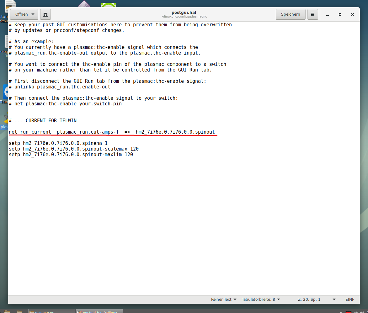

19 Aug 2020 21:26 - 19 Aug 2020 21:28 #178768 by hermann1976
I have now managed to transfer the power to the plasma generator.
The spindle was still missing to switch on permanently with:
postgui.hal:
net run_current plasmac_run.cut-amps-f => hm2_7i76e.0.7i76.0.0.spinout
setp hm2_7i76e.0.7i76.0.0.spinena 1
setp hm2_7i76e.0.7i76.0.0.spinout-maxlim 120
setp hm2_7i76e.0.7i76.0.0.spinout-minlim 0
setp hm2_7i76e.0.7i76.0.0.spinout-scalemax 120
I have set the scaling and the maximum limit to 120 because 12V comes from the plasma generator.
As already mentioned, it is not possible for me to directly assign a value to the setting of the amps in the run tab. I can only jump up and down with the arrows.
Thanks again for your help.

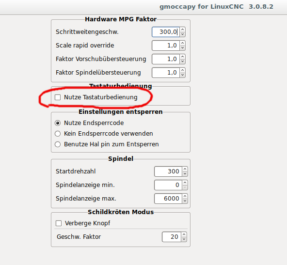

Sorry, i forgot to mention that the problem is with the gmoccapy user Interface.
20 Aug 2020 08:47 #178810 by phillc54
OK, it seems that Gmoccapy doesn't work correctly if keyboard shortcuts are enabled.
I don't think there is anything I can do about that. :(

21 Aug 2020 18:39 #178948 by hermann1976
I found out why I couldn't edit any entries (neither nor feed rate, ampere, ect.)
In the settings it is possible to activate or deactivate the keyboard operation in the hardware tab (gmoccapy).
If I activate it then I should be able to use the keyboard, right?
But when activated I cannot set any keyboard entries. If I deactivate it then I can edit the entries. Is that twisted?

21 Aug 2020 20:26 #178954 by hermann1976
I just updated linuxcnc.
Now linuxcnc no longer starts. If I comment out the entry "net run_current plasmac_run.cut-amps-f => hm2_7i76e.0.7i76.0.0.spinout" then linuxcnc works again, but the current value is no longer output (before it was working).
21 Aug 2020 22:23 #178962 by PCW
Is it possible you need to update your PlasmaC version to the latest?
if you re-installed LinuxCNC you may have and older version of PlasmaC
