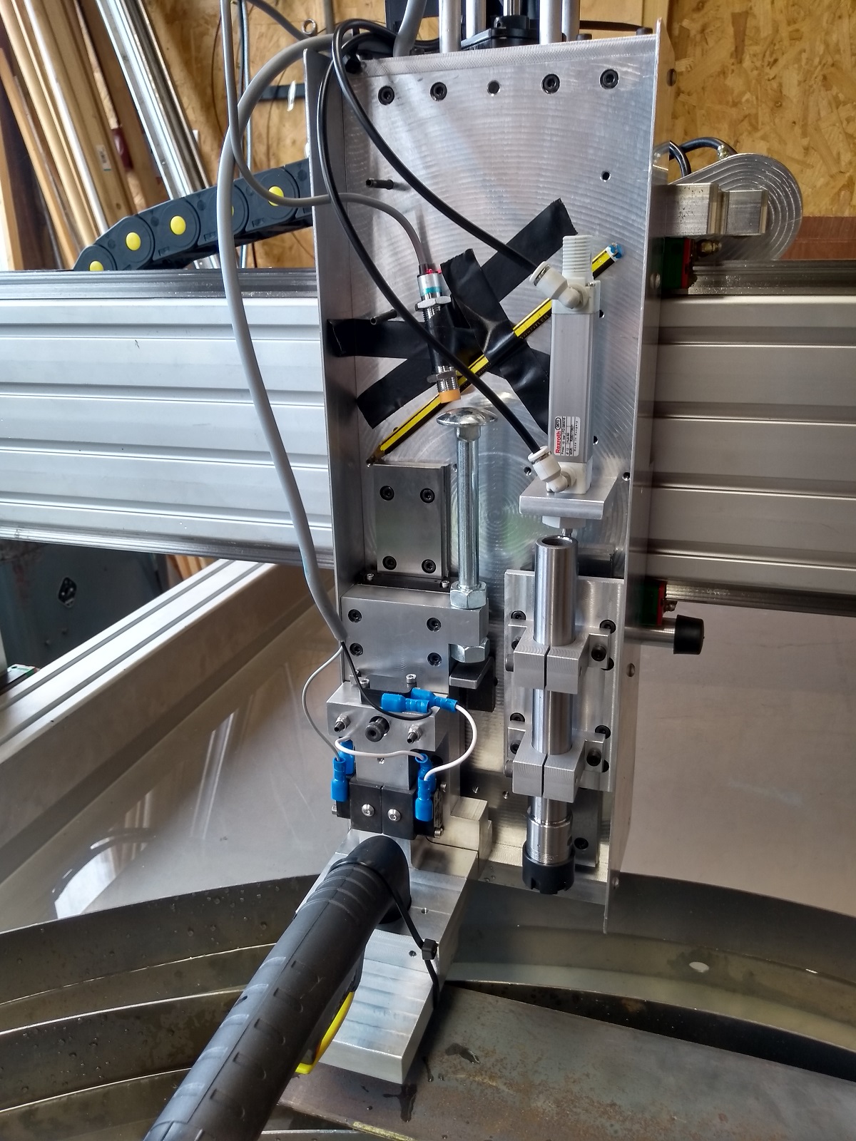

Looks like I need to rethink the float switch anyway! When the torch fires it throws the float switch too. It's so close to doing something useful...
- Posts: 21889
- Thank you received: 7462
31 Aug 2020 15:11 #180179
Replied by tommylight on topic Plasmac migration problems
Seems like interference from the torch/cable.
Are all signal cables from switches/sensors shielded and grounded on the electronics side ?

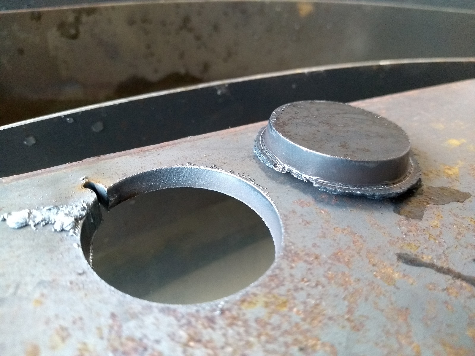

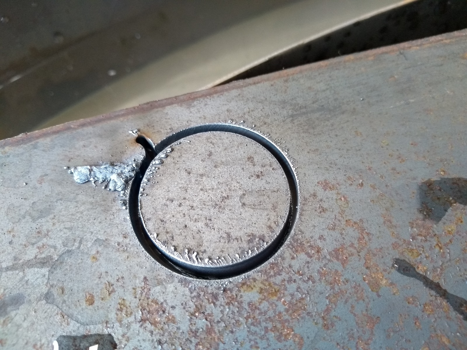

31 Aug 2020 15:34 - 31 Aug 2020 15:35 #180181
by Mud
Replied by Mud on topic Plasmac migration problems
I think it was going through the air, but for what it's worth all of my signal shields go to star ground in the cabinet. I played a bit with moving the sensor in the air and seeing it trip, and it seemed like it's just a line-of-sight proximity effect. See my bodge and first cut...I did not expect this quality on my first go, I'm blown away. Thanks for all the help so far.
Edit to add, that's a 30mm hole in 5mm steel.

31 Aug 2020 17:51 #180196
Nice cut and a nice solution !
