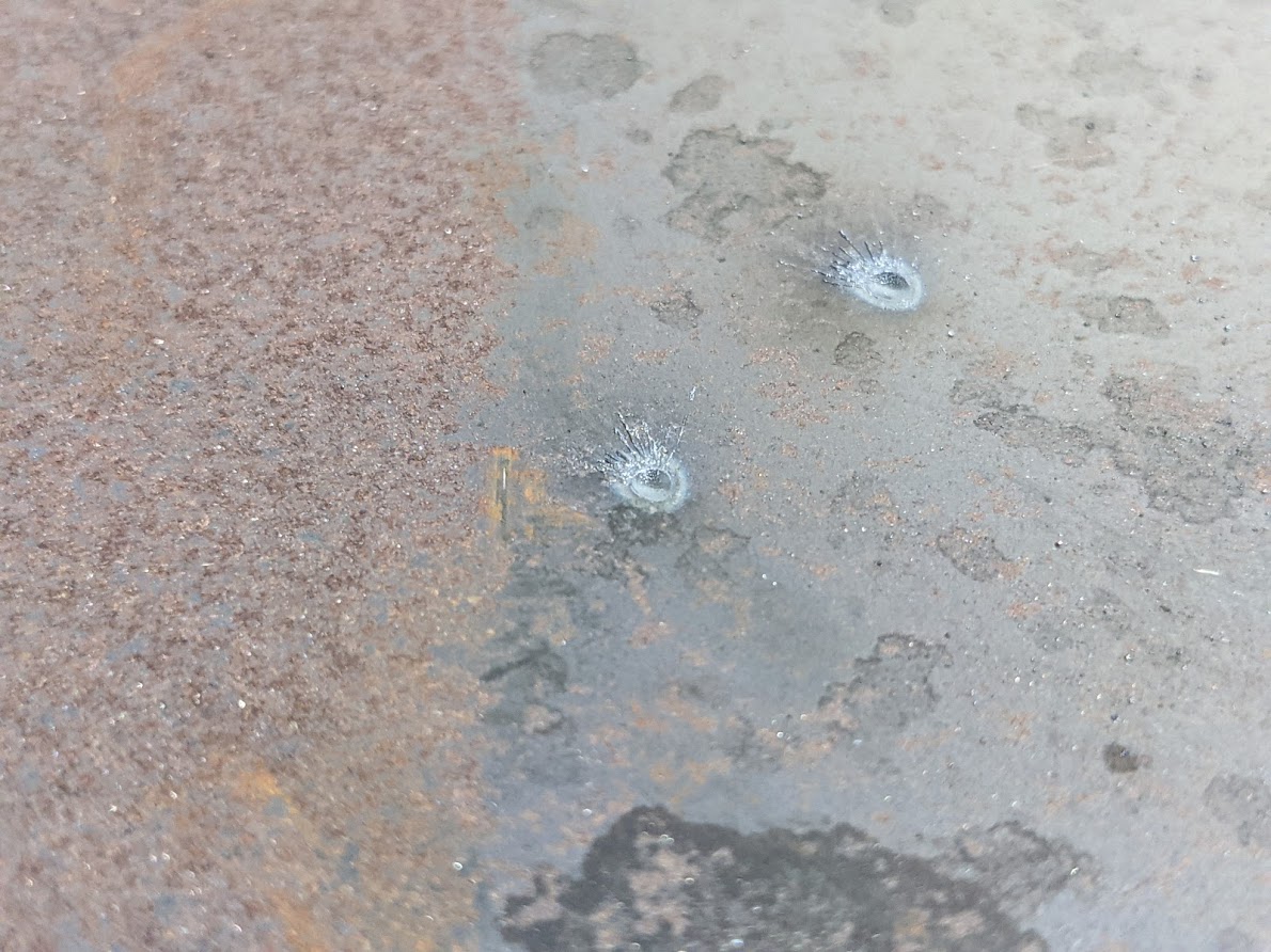

08 Sep 2020 16:15 #181295
by AgentWD40
Replied by AgentWD40 on topic Hypertherm Powermax45 XP SheetCam Tools And PlasmaC Materials
I thought I'd add the Marking and Dimpling settings. As you all know the powermax machines have a marking and dimpling cut mode and specific consumables for this purpose.
Regarding spotting/dimpling, how are powermax users handling this between the machine settings and/or just using the spotting techniques designed into plasmac? What's your procedure? Do you actually swap consumables or lower the amperage (via manual or rs485)?
