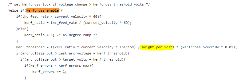

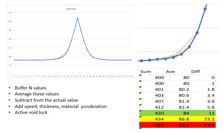

- grijalvap
- Posts: 200
- Thank you received: 63
13 Jul 2021 16:50 - 13 Jul 2021 17:48 #214617
by grijalvap
Replied by grijalvap on topic THC Velocity lock and void lock
Last edit: 13 Jul 2021 17:48 by grijalvap.
