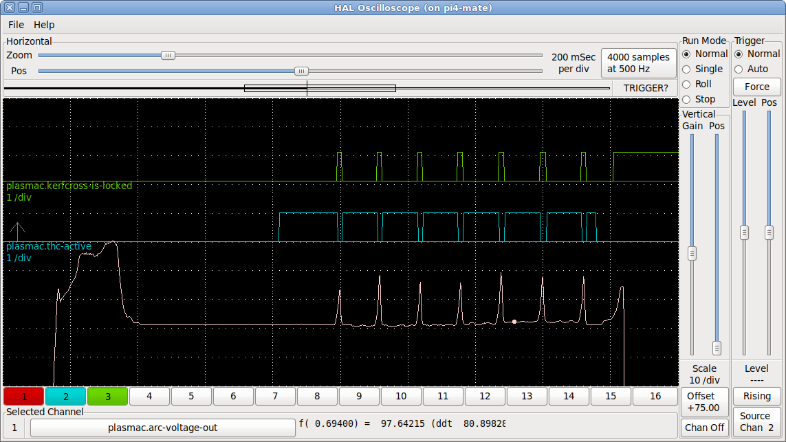

This is what it looks like in halscope
Ref:  forum.linuxcnc.org/plasmac/37886-void-lo...stion?start=0#165191

The reason why your plot differs to what I shared is that you are plotting arc voltage not dv/dt
Maybe a bit text on the image may have helped. :)

From the look of your plot it would be better to use the arc voltage plot then the calculated dv/dt plot.
I don't think thats a good example with all the oscillations. I did not enable the THC and the thc disable signal was doing nothing cos I valued my torch! I can't really remember what I had it set at when I went live. I did a lot of plots of normal cutting so I could watch the data to get my head around it before writing any void sensing code.
The number of readings to average is configurable. I think  I used 100 which was 0.1 seconds worth
What makes you say voltage was better? With all the observations I did, I thought I could set a safe threshold with dv/dt but not on just voltage alone.
