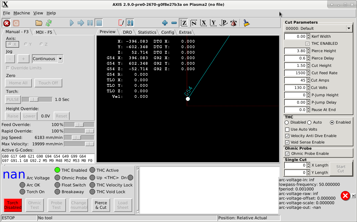

23 Sep 2020 04:28 - 23 Sep 2020 04:29 #183391
by Tesremos
Replied by Tesremos on topic Nan - voltage
here is your generated error
edit: and now i know how to screenshot!!! winning
Last edit: 23 Sep 2020 04:29 by Tesremos.
- Posts: 12163
- Thank you received: 4151
23 Sep 2020 04:35 - 23 Sep 2020 04:37 #183392
So clearly as I suspected, and mentioned before, the calibration values in the GUI are not making it to plasmac.comp.
The simplest workaround is to configure Plasmac in hal. Try something like this in your postgui.hal file
EDIT: There is no need at all to have these values in the GUI as once set up, they never need changing. I suggest taking those values out and using some INI file settings to populate them (or a setp in my connections)
Replied by rodw on topic Nan - voltage
unlinkp plasmac.arc-voltage-offset
unlinkp plasmac.arc-voltage-scale
setp plasmac.arc-voltage-offset <your_offset_value>
setp plasmac.arc-voltage-scale <your_scale_value>EDIT: There is no need at all to have these values in the GUI as once set up, they never need changing. I suggest taking those values out and using some INI file settings to populate them (or a setp in my connections)
