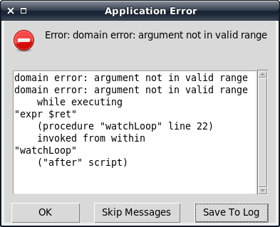

So infinity * 0 = 0 so how can it report a nan?
No, inf * 0 = nan
When you go back to the First post and look at the screen dumps arc-voltage-in has a valid value but arc-voltage-out has a nan.
The first screen dumps were not at the time of startup, they were after the error had been established.
Maybe the one second delay simply allows the system to sort itself out. eg for the system to load.
Exactly, it gives time for the encoder to pass a valid float.

So was it just the display value or was the arc voltage used by plasmac wrong too? You would not have thought you'd start cutting 1 second after turning the machine on.
23 Sep 2020 06:28 #183411 by phillc54
Replied by phillc54 on topic Nan - voltage
Both the display and all the plasmac comp calculations.
I just tried on a sim and everything seems to come back to normal afterwards. It gave this vague error dialog:
Warning: Spoiler!
23 Sep 2020 07:32 #183417 by rodw
Replied by rodw on topic Nan - voltage
Looks like Dewey has pushed a fix to halshow.tcl 6 hours ago so it would be interesting to recompile master and try again
"halshow.tcl support display of nan"
github.com/LinuxCNC/linuxcnc/commit/accd...c21d2d3b5d208b0c1438

Sorry, just to be clear, WatchLoop in in that file.
Now I know where that message came from.
