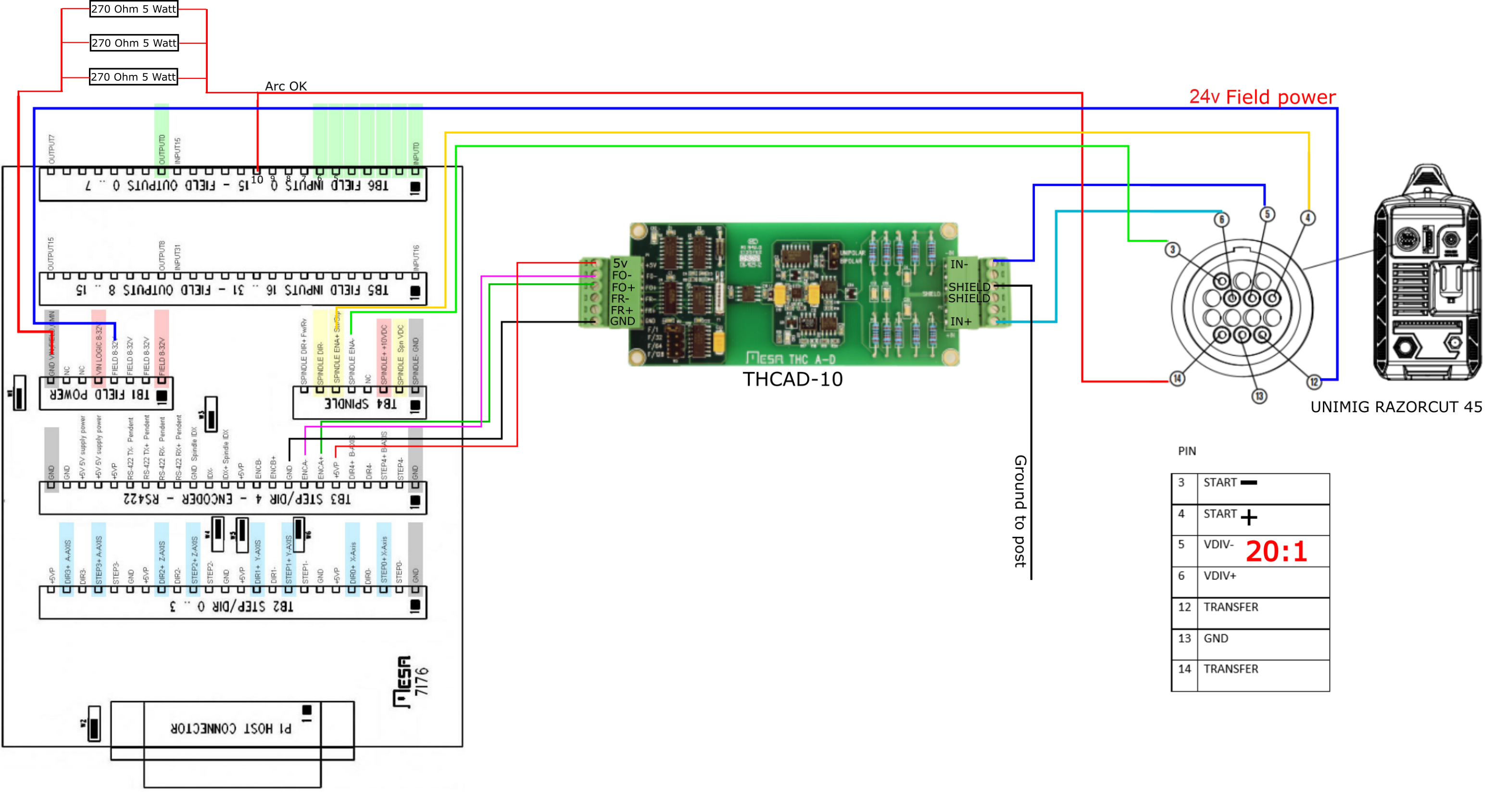

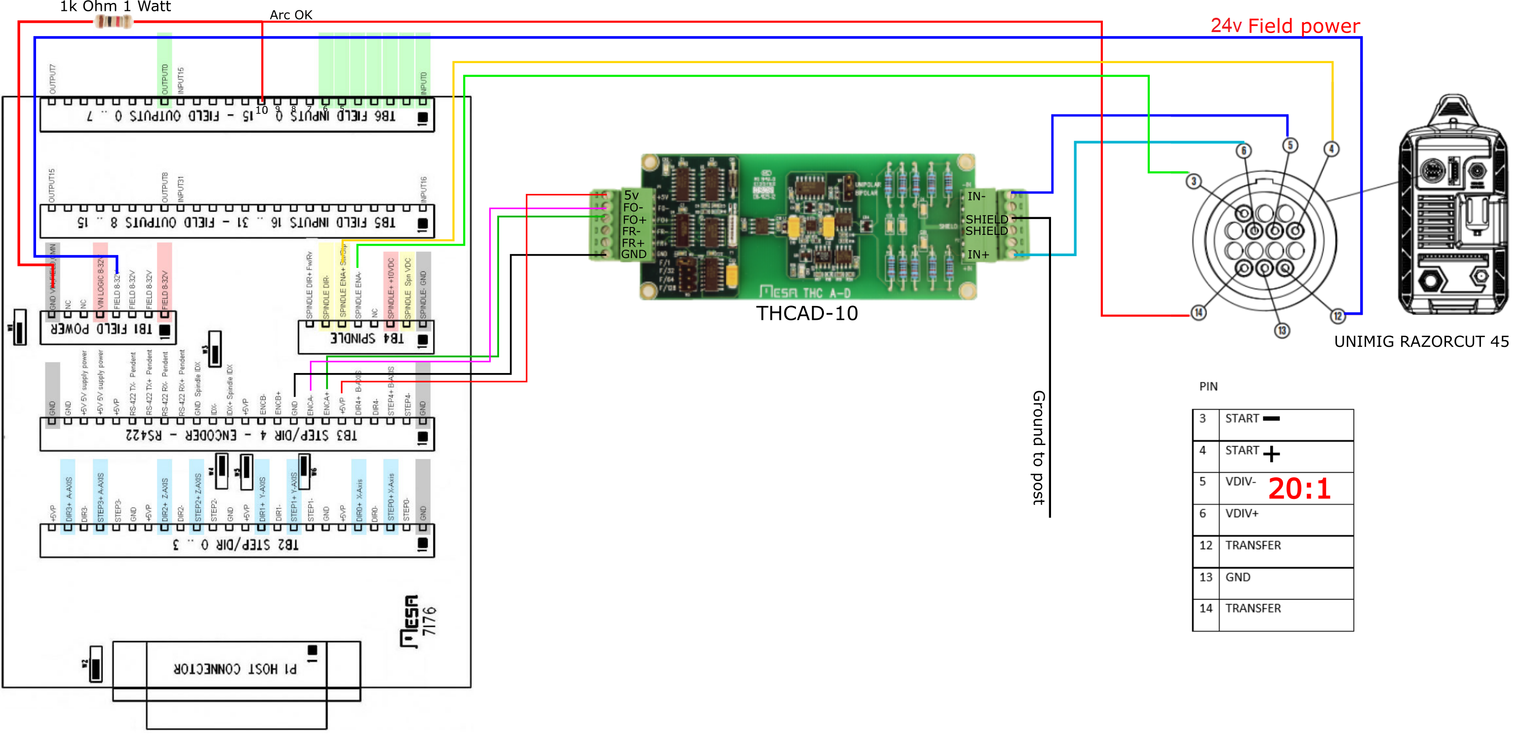

Last post first schematics shows a wiring error that will cause the ARCOK (transfer) to short the VFIELD power.
I really hope it is not wired like that.
(No i wasn't sure on that first one)
At the moment its wired like this
Swapping to this. Hoping it works to burn off the oxidization.
Last edit: 12 Dec 2020 20:16 by luftlupus.

12 Dec 2020 21:23 #191781 by tommylight
Replied by tommylight on topic Arc OK intermitent issues on torch fire
That is all good.

13 Dec 2020 08:10 #191816 by rodw
Replied by rodw on topic Arc OK intermitent issues on torch fire
The second diagram with the resistors looks right to me.

13 Dec 2020 08:20 #191817 by luftlupus
Replied by luftlupus on topic Arc OK intermitent issues on torch fire
Cheers for the confirmation, ill let ya know at the end of the week if its cleared up.
13 Dec 2020 09:34 #191834 by rodw
Cool. Just be prepared for a few runs before it clears up the oxide. It took me about 3 goes, but little_sparky needed 10-12 goes. I'm confident it will work for you.

22 Dec 2020 01:49 #192758 by luftlupus
So i heard back from the manufacturer and he said The maximum current for the transfer relay is 50mA so im assuming ill need different capacitors again to not burn it out.
22 Dec 2020 02:11 #192759 by rodw
In that case a 1 k, 1 W resistor will draw 24 mA. The plasma cutter on your wiring diagram does not even mention it has a CNC interface in our country.

22 Dec 2020 02:15 #192761 by luftlupus
That is what i had installed previously but am running into said issues, like its just not enough. As for the machine yer its not very well documented but it mentions it in the manual
This browser does not support PDFs. Please download the PDF to view it: Download PDF
22 Dec 2020 02:30 - 22 Dec 2020 02:31 #192766 by rodw
Yeh, I read that brochure. As you say its similar to the everlast. I would open the case and follow the Arc OK wiring back to the relay. Note the part number and google the relay. 50ma does not sound right anyway. Thats more like the current draw of the coil I think.
