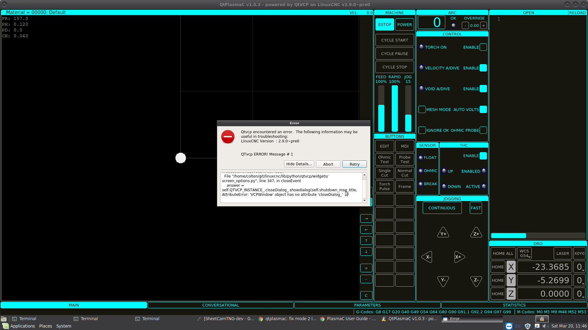

20 Mar 2021 12:51 #202999
by crowloy
Replied by crowloy on topic QtPlasmaC release.

20 Mar 2021 15:40 #203036
by snowgoer540
Replied by snowgoer540 on topic QtPlasmaC release.
That seems to be a bug with qtvcp. Specifically the screen_options widget.
I am sure that Chris or Phill will be able to fix it pretty easily.

21 Mar 2021 08:20 #203117
by snowgoer540
You might have more success posting this error to the QTVCP section as it’s not a qtplasmac error.
Just be aware Chris hasn’t been as active lately due to work obligations. So may be a few until he chimes in.

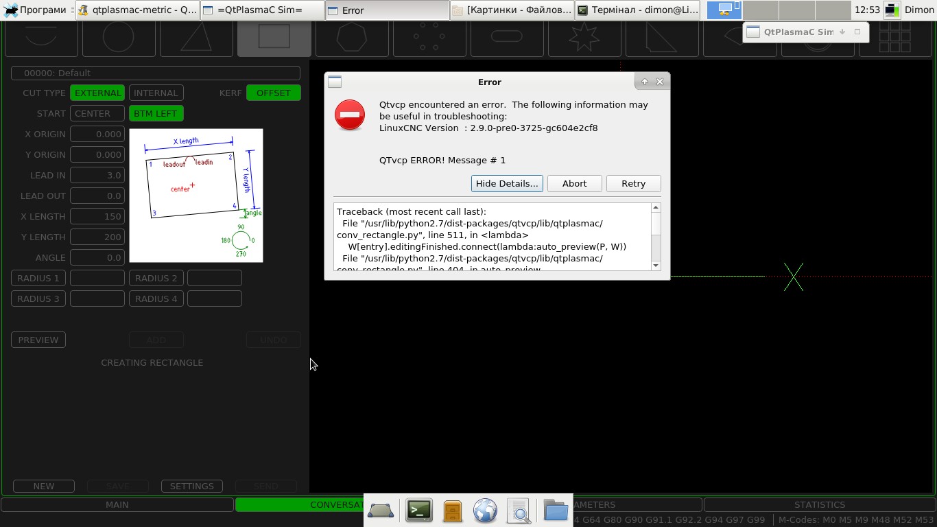

28 Mar 2021 05:29 - 28 Mar 2021 05:31 #203875
by Franklin
Replied by Franklin on topic QtPlasmaC release.
Hi I am trying to use QtPlasmaC and in the conversational tab I keep getting the error message. I tried on two computers and get the same errors.
File "/usr/lib/python2.7/dist-packages/qtvcp/lib/qtplasmac/conv_rectangle.py", line 511, in <lambda>
W[entry].editingFinished.connect(lambda:auto_preview(P, W))
File "/usr/lib/python2.7/dist-packages/qtvcp/lib/qtplasmac/conv_rectangle.py", line 404, in auto_preview
preview(P, W)
File "/usr/lib/python2.7/dist-packages/qtvcp/lib/qtplasmac/conv_rectangle.py", line 110, in preview
kOffset = float(W.kerf_width.text()) * W.kOffset.isChecked() / 2
ValueError: invalid literal for float(): 1,00Attachments:

28 Mar 2021 05:33 #203876
by phillc54
Replied by phillc54 on topic QtPlasmaC release.
What is the value of the kerf width for the default material?
- Franklin
- Posts: 47
- Thank you received: 19
28 Mar 2021 06:00 #203880
by Franklin
the default was 1, I tried different values, and created new materials. The result is the same.
I am using LinuxCNC 2.8.0 Debian 10 Buster PREEMPT-RT ISO
and updated to the master.
- phillc54
- Posts: 5711
- Thank you received: 2100
28 Mar 2021 06:02 #203881
by phillc54
After looking a bit closer it may be a locale issue, I see 1,00 and it is probably expecting 1.00
I will have a look at this tomorrow.
- Franklin
- Posts: 47
28 Mar 2021 06:20 #203884
by Franklin
I also noticed that the "kerf offset" button is only active in the "greating circle" and "greating bolt circle" tabs, in other tabs the "kerf offset" button does not respond when pressed.
When in the settings I enter any value in the In the input box '"lead in" and save it, the "kerf offset" button becomes active in all tabs
- phillc54
- Posts: 5711
28 Mar 2021 06:25 #203886
by phillc54
That is correct, in all the shapes except circle and bolt circle the offset is done with G41.1 or G42.1 both of which require a lead in.
