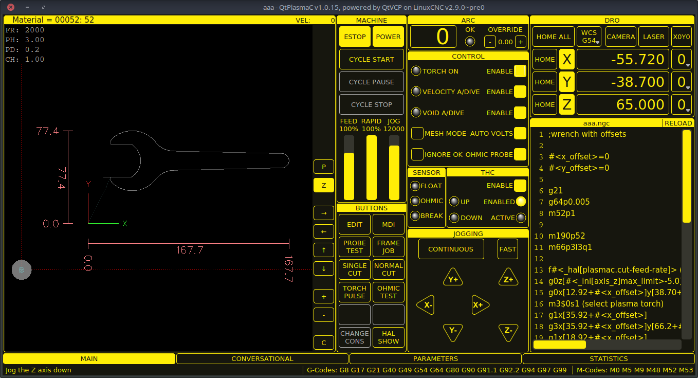

A few folk have asked if it was possible to move the DRO to the top of the GUI.
There is now an option that can be set in the .ini file to do this for both the 16:9 and 4:4 display formats.
In the [QTPLASMAC] section of the .ini file add the following:
DRO_POSITION = top
14 Apr 2021 09:47 #205867 by Clive S
Replied by Clive S on topic QtPlasmaC release.
With me getting old and a bit forgetful may a I ask a newbie question?
I run mint 19.2 with 2.8.1 on several machines but I am missing out on QTplasmaC. I realise I need 2.9 master
Q.1 So do I have to install Buster (that I don't like) or can I still use mint updated to 2.9 ?
Q.2 Is there a different GUI colour other than yellow ?
Sorry if this post is in the wrong place if so can you move it elsewhere. (not to the bin I hope) :)

14 Apr 2021 10:01 #205870 by phillc54
Replied by phillc54 on topic QtPlasmaC release.
AFAIK it should work on Mint.
Colours are user changeable, see the GUI SETTINGS chapter here:
linuxcnc.org/docs/devel/html/plasma/qtpl...ml#qt_parameters-tab
