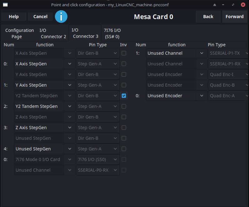

I have tried to set up from scratch with Pnconf and 7i96 board.
I could not see ow to do a tandem axis so I went with 3 axis and hand edited the hal and ini file.
I have got the gui to load and does show me things like breakaway and sensors working with halshow.
When it is load it shows 3 axis XYZ ie not the 4th I can't get anything to jog and not sure if it is in estop the motors are locked.
Could someone please take a look at my files

17 Apr 2021 17:45 - 18 Apr 2021 19:45 #206200
by snowgoer540
Replied by snowgoer540 on topic Help with QTplasmaC
It might be better to start pncconf, and edit it that way.
You just click on the drop down, click Axis > Tandem Axis > pick whatever suits your tandem axis, usually it's Y, so Y2 Tandem StepGen.
That's it really.
The only thing that is confusing is you may have to invert the direction for one of the Y motors. It will be listed under that Joint, but it's confusing because it's next to "Unused StepGen" then Dir Gen-B, and you can click Inv there.
I show it clicked in this view, just so you can see it, you'll have to figure out if you need it or not.
That's it really.

17 Apr 2021 17:54 - 17 Apr 2021 18:00 #206201
by Clive S
Thanks for looking at it. I did try with pncconf using the tandem axis but it still only showed 3 axis. pnconf only gives you the choice of XYZA
It does load now so must be nearly there. Should it show 4 axis before it is homed ? like it does with PlasmaC
edit : I used pncconf to get the 3 axis then added the other axis and joint. So can't used it again as it will overwrite what I have got so far.

17 Apr 2021 18:43 - 17 Apr 2021 18:44 #206205
by Clive S
In pncconf you have the choice of lathe XZ mill XYZ and XYZA I tried with XYZA and putting tandem Y axis in everything went fine untill the end when It started asking for details for the A so it would not let me carry on so I had to exit out.
Should iQTplasmaC show the 4 axis at startup as it is only showing 3 at the moment. Homing is not working but all the sensors are ie float, breakaway , home switches apart from Y2
I already have a working PlasmaC on another drive but it is an old version of Linuxcnc. on 2.8.
I will have another go at it tomorrow.

17 Apr 2021 18:53 #206206
by robertspark
Replied by robertspark on topic Help with QTplasmaC
if you have an X, Y an Z axis machine with a 2nd X or Y axis just select and xyz machine
then when you get to select the axis pins / ports, select X, y and z MAIN axis
AND either a TANDEM X or Y axis.
it will copy the X or Y parameters to the tandem axis automatically

17 Apr 2021 19:42 #206213
Replied by tommylight on topic Help with QTplasmaC
Exactly, choose XYZ.if you have an X, Y an Z axis machine with a 2nd X or Y axis just select and xyz machine

- Posts: 18044
- Thank you received: 5297
17 Apr 2021 20:29 #206223
I would think that's correct
Regardless of how many joints you have
you still have a 3 axis XYZ machine
Replied by PCW on topic Help with QTplasmaC
QTplamaC is only showing 3 axis
