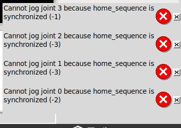

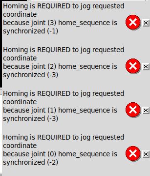

19 Apr 2021 19:40 - 19 Apr 2021 19:45 #206458 by snowgoer540
Replied by snowgoer540 on topic Help with QTplasmaC
[kins]
something something kinstype=both
That at the end will decide if you can jog or not while in Joint mode before homing the machine.
I always set it so it can not jog Y (tandem) axis without homing, but X and Z can be jogged before homing.
This has rapidly declined. That is not really what kinstype=both does.
Using Axis as an example, the following in an .ini file will show Axes X Y Z as needing to be homed:
[KINS]
JOINTS = 4
KINEMATICS = trivkins coordinates=XYYZ
The following in an .ini file will show Joints 0 1 2 3 as needing to be homed:
[KINS]
JOINTS = 4
KINEMATICS = trivkins coordinates=XYYZ kinstype=BOTH
Adding a negative sign to the joint HOME_SEQUENCE for the corresponding joints that make up an axis will prevent jogging before homing... This is true whether or not you have set kinstype=both or not.
With kinstype=both:
Without kinstype=both:
