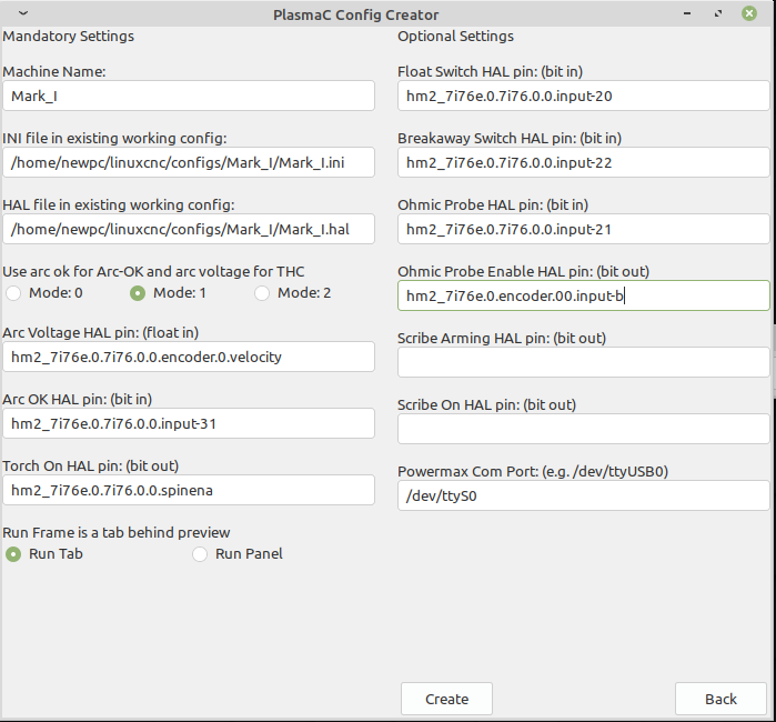

20 Apr 2021 19:38 #206558
by txtrone
This is what I have, anything look out of whack?
Replied by txtrone on topic Torch On HAL Pin when using 7i76e
Yes, thats the correct pin in hal.
Wire it up, turn your plasma cutter off, fire up the control box and power up your plasma cutter. If the torch comes on or your plasma cutter faults, swap the pins around. and try again.

20 Apr 2021 19:48 #206560
by txtrone
This is the error I received when I tried to run plasmac with the initial parameters from the above post...

- snowgoer540
- Posts: 2561
- Thank you received: 891
20 Apr 2021 20:07 - 20 Apr 2021 20:10 #206561
by snowgoer540
That's the error in all those lines
Check your port for the RS485 comms. You can use the pmx_test.py script to help you identify the correct port. Its usage is covered in the user guide.
I suspect it's going to take issue with your ohmic enable HAL pin next as you are feeding a bit output to an encoder.
Replied by snowgoer540 on topic Torch On HAL Pin when using 7i76e
Could not open /dev/ttyS0 for Powermax communications
Last edit: 20 Apr 2021 20:10 by snowgoer540.
The following user(s) said Thank You: txtrone
- Posts: 21840
- Thank you received: 7456
20 Apr 2021 20:35 #206567
Replied by tommylight on topic Torch On HAL Pin when using 7i76e
Ohmic Probe Enable must be an output, not input.

20 Apr 2021 20:38 #206569
by snowgoer540
True, but it looks like he's attempting "hypersensing", so he will need one of the ohmic components. There's a few threads around here that explain it better than I can off the top of my head.
- Posts: 12094
- Thank you received: 4132
20 Apr 2021 21:40 #206574
Replied by rodw on topic Torch On HAL Pin when using 7i76e
The ohmic pins do not seem right regardless of the ohmic method. But Thats not the error here as Snowgoer pointed out.
Perhaps disable the RS485 comms for now and sort out the rest of the config. Mainly ohmic sensing.
- txtrone
- Posts: 384
- Thank you received: 106
20 Apr 2021 21:45 #206577
by txtrone
Ok. Can I comment out the RS485 in the 'new' main ini file?
Any pointers on the ohmic pins?
