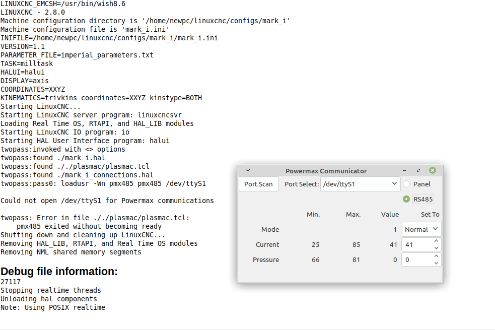

I ran the pmx_test script. Found the port, S1 in my case, I can change the drop down box on the test screen and verify it is changing modes on my plasma unit (Normal, CPA, Gouge) ... I changed the ini file to /dev/ttyS1 ... got the following errors.

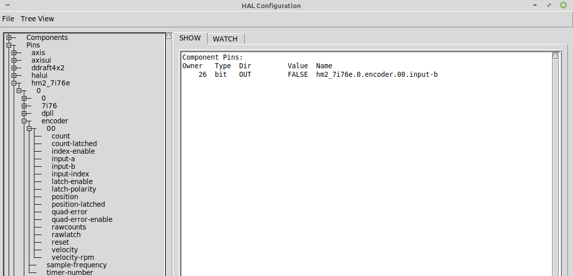

What does Type and Dir mean on HAL Show in my attached screen cap?
Replied by txtrone on topic Torch On HAL Pin when using 7i76e
This is what I have, anything look out of whack?
Ohmic Probe Enable must be an output, not input.
- Posts: 21840
- Thank you received: 7456
21 Apr 2021 14:58 #206657
Replied by tommylight on topic Torch On HAL Pin when using 7i76e
Type is the type of pin, be it bit, float, s32 etc.
Dir should be the direction of the signal looking from the LinuxCNC point of view. Might wana check this as i am a bit cloudy...
As for coms, might need to add the user to dialout, here is one of the many topics about that:
arduino.stackexchange.com/questions/7471...d-to-group-dialout-o
The following user(s) said Thank You: txtrone

Does that mean the aforementioned 'encoder input-b' is actually a 'bit out' or am I misunderstanding?
- Posts: 21840
21 Apr 2021 15:33 #206665
It is for LinuxCNC, but not for us and not for the encoder, it is an input.

In Phillc54's response he marked up the image to call attention to 'bit out' and 'input-b'. I took that to mean there is a correlation between these two. Can you suggest an encoder output that might be suitable?
- Posts: 21840
21 Apr 2021 16:14 #206669
This went sideways rather quickly...
The "Ohmic Probe Enable" pin in the configurator must be a physical output that is wired to the relay that activates the power going to the sensing part of THCAD.
Any normal output can be used for that.
