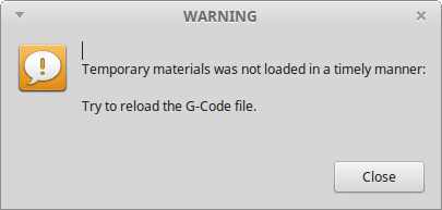

29 Apr 2021 04:56 #207353
by phillc54
Replied by phillc54 on topic Sheetcam and trying to generate spotting gcode.
You are attemting to use two temporay materials in this file which doesn't work, only the last one will be used.
linuxcnc.org/docs/devel/html/plasma/plas....html#magic-comments
It seems to fall over because it reads the gcode file quicker than it can create the temporary materials, I think it needs to be reversed and only use the first one then give an error popup if it sees any more.
This works around the timing issue if you want to try it. In /configs/by_machine/plasmac/plasmc_gcode.py there is a function:
def write_temp_default_material(data):
add this as the first line:
time.sleep(0.25)
time.sleep(0.25)

02 May 2021 18:03 #207660
by snowgoer540
In the attached file, there are two different material magic comments in the same cut file.
I am curious, why would you want to have two different materials in the same cut file?
Just intrigued what the use case is for this.
Replied by snowgoer540 on topic Sheetcam and trying to generate spotting gcode.
I found the result from when we tested this some time back, with 500 materials the maximum time to change was 0.16 seconds. I don't "think" anything has changed in the meantime.
This is the error I'm getting on loading the file with magic comments
Using the post above
which does:;begin material setup T0 M6 (select plasma tool) G43 H0 (apply tool offsets) (o=0, ph=4.1, pd=0, ch=4.1, fr=100, pe=0.5) F#<_hal[plasmac.cut-feed-rate]> ;end material setup

02 May 2021 18:09 #207662
Because one is a drilling operation for spotting on one layer and the other is a jet tool for plasma cutting.
Sheetcam loads a tool for each operation.
Replied by rodw on topic Sheetcam and trying to generate spotting gcode.

02 May 2021 18:57 #207668
Well no cos it would not load as above.
But yes, that was the whole point as magic comments will let Sheetcam be the master of the materials with Les's post..
I think that would be expected behaviour from the post processor on a tool change for the second operation.
I didn't write the code, Les did!
