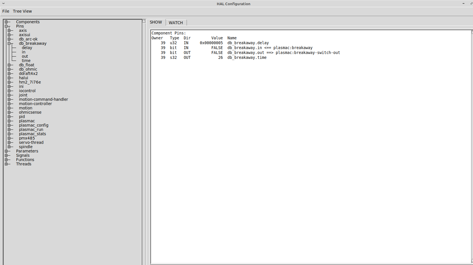

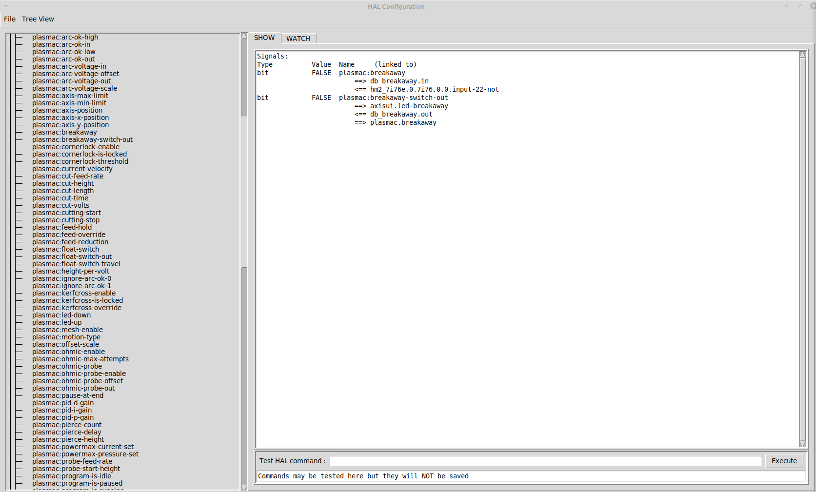

30 Apr 2021 20:41 - 30 Apr 2021 20:44 #207486
by txtrone
You were right about syntax, there was an error in the line 'halui.program-pause' I corrected it to 'halui.program.pause' ,,, but then I get this error:
The contents of my hal file 'HALUI signals' section:
Here are some screenshots from hal show. I am just not understanding where the breakdown in communication is between hal and plasmac. The sensor is working, lights indicating on the plasmac axis gui, indicating in hal show, just will not stop the gantry.

#net db_breakaway halui.program.pauseHere are some screenshots from hal show. I am just not understanding where the breakdown in communication is between hal and plasmac. The sensor is working, lights indicating on the plasmac axis gui, indicating in hal show, just will not stop the gantry.
