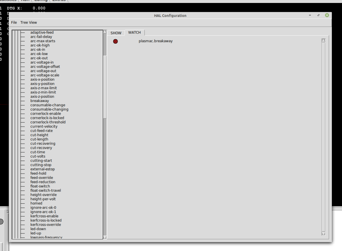

Are you referring to these?
Replied by txtrone on topic Breakaway sensor config
There is a breakaway input in plasmac. You need to connect that.
#***** PLASMA CONNECTIONS *****
net plasmac:arc-voltage-in hm2_7i76e.0.encoder.00.velocity => plasmac.arc-voltage-in
net plasmac:arc-ok-in hm2_7i76e.0.7i76.0.0.input-31 => db_arc-ok.in
net plasmac:float-switch hm2_7i76e.0.7i76.0.0.input-21-not => db_float.in
net plasmac:breakaway hm2_7i76e.0.7i76.0.0.input-22-not => db_breakaway.in
net plasmac:ohmic-probe hm2_7i76e.0.7i76.0.0.input-20-not => db_ohmic.in
#net plasmac:ohmic-enable plasmac.ohmic-enable =>
net plasmac:torch-on => hm2_7i76e.0.7i76.0.0.spinenaPlease Log in or Create an account to join the conversation.

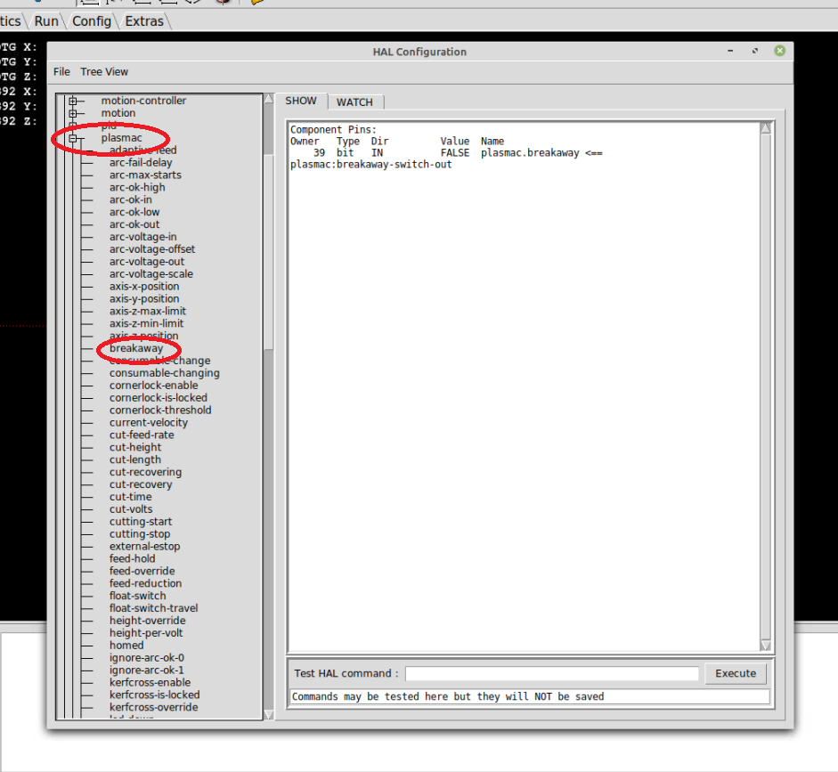

In my non QT verion of PlasmaC, the pin is plasmac.breakaway,
It is under the plamac pins,

I might be wrong here but the pin is called halui.program-pause so if you are not running a gcode program there is no program to pause!
Jogging is not running a program!
Write some gcode, run it and its while running, grab the torch and yank it off. I think it should stop.

But doesnt PlasmaC have a built in pin for attaching your torch break away input? He mentioned that he tried connecting to halui.program.pause but got an error saying that was already linked.

Yeh, its already linked to the debounce output and his GUI indicators light up. I think the OP has been testing it while jogging which won't work (no program running).

Correct, thanks for helping me figure that out Rod!
