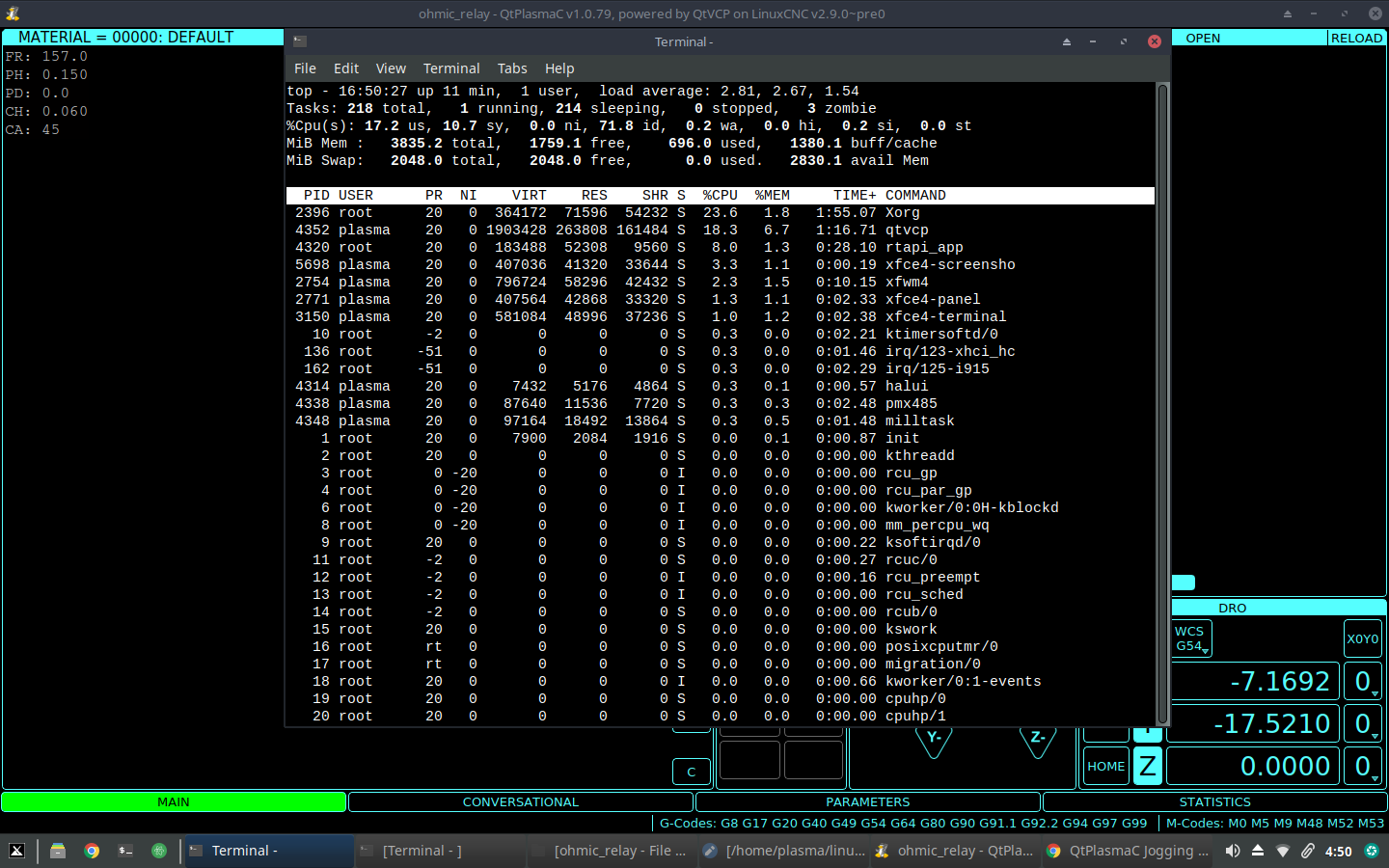

That's good info. That may make it easier to figure out.
When I get home I will run the latest version on my table and see if I see the same thing.
I will say that I've been simulating 1.0.76 a lot on a VM (with the to-be 1.0.77 changes applied), and I didn't see these issues. Again, not to say they don't exist. Just odd that QTVCP seems to go bezerk for sometimes for people, but not always for everyone.
Not sure if it matters or not, but do you see this issue immediately from startup? Or do you use theGUI for any length of time before the CPU pegs at 100%? What I am getting at, is - is there a certain thing that you do that afterward it pegs the CPU?

The issue is pretty much immediate after launch. I disable ESTOP and click power on and nothing else and its at 100%. Took ~45 seconds from the moment the process starting according to top.

02 Sep 2021 20:49 - 02 Sep 2021 20:50 #219464
by snowgoer540
Replied by snowgoer540 on topic QtPlasmaC Jogging Lag
Just updated to 1.0.79, and I dont experience any lagginess. Below is a screenshot of top.
I would say it's definitely because your CPU is pegged (obviously) but I wonder what causes that.
It makes me wonder if there is something wrong with your qtvcp installation, or some conflict going on. I will say that of the 4 people I know of that experience lagginess, 3 of them run Mint. Not saying it's the issue, and correlation does not equal causation, but still it may not be a coincidence.

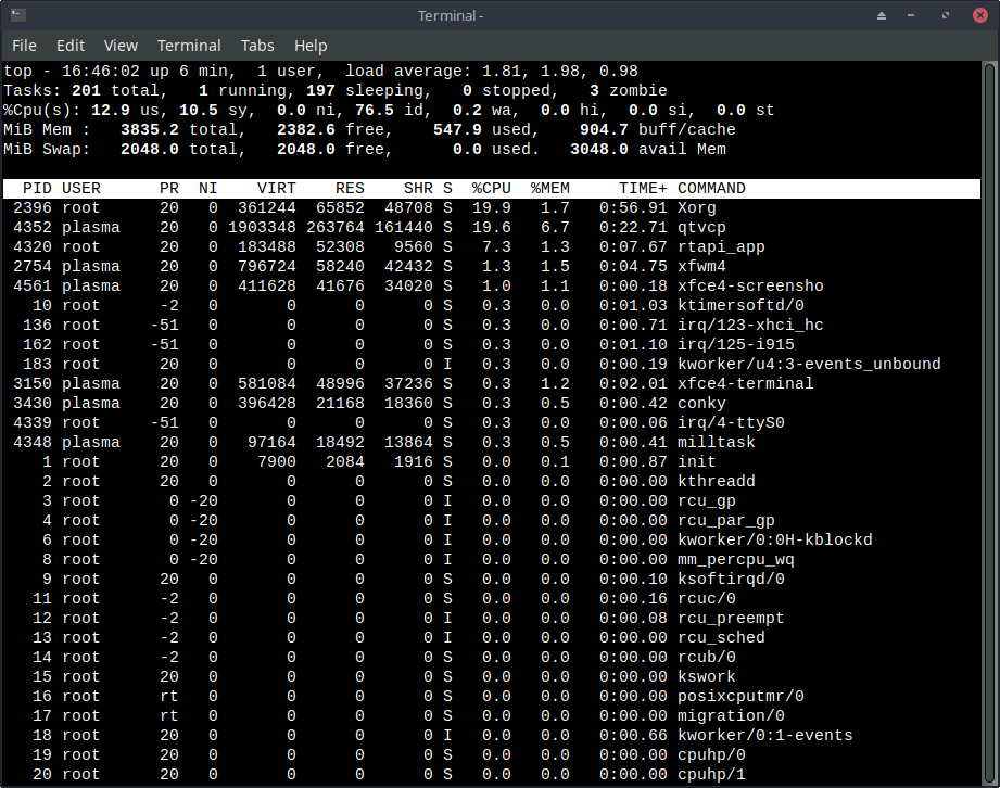

02 Sep 2021 20:51 #219465
by snowgoer540
- Posts: 21813

I have pushed a change to slow down the flash rate which eases up on the cpu usage.
I don't know why Bryans runs at 100%. I made a sim from the posted config and it runs on my development VM at 10% with the update.
P.S. Did I mention that I HATE this forum editor, it is a right royal PITA.

I applied the fix and it did lessen the lag. During idle state, CPU usage is ~70%. When I am jogging around it goes to about 85-90%. I would say the lag has been cut by 90% or so. Although it is usable now, I still think that I am going to be switching over to MX 21 as I could probably use a fresh start anyway.
