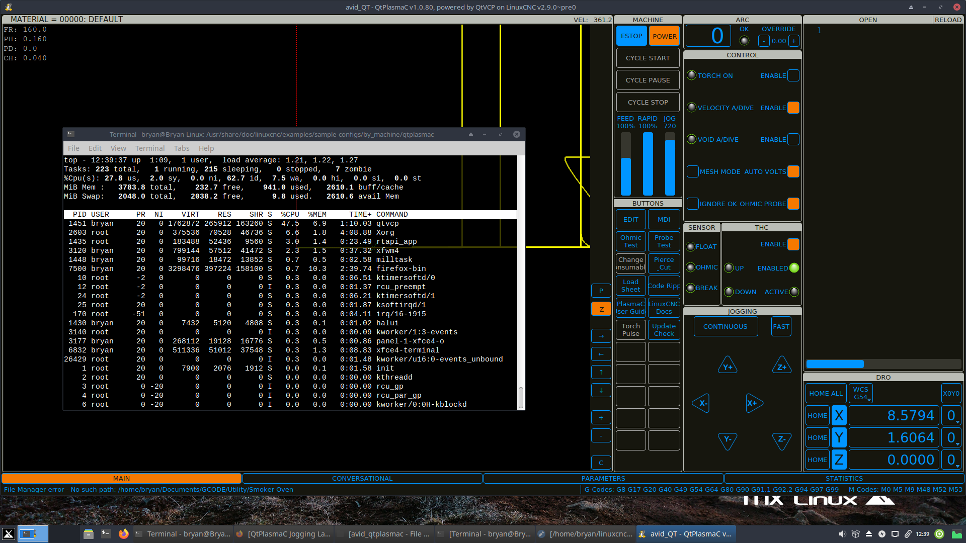

I would recommend 19.4. I think someone around here didnt have success with 21, I cant remember the issue or who it was though.
I do know that the "ahs" version is not usable though, reckon Phill confirmed that.
If you run into any snags, let us know.

Oops, yes, I meant 19.4. That is the one I grabbed earlier (non ahs)

I've no idea your level of experience with Linux and what not, so disregard if this is stuff you already know, but:
Installing the rt kernel is as simple as:
The key I've had success with most recently:
And I find it easiest to to install a package version of lcnc first even if you want to RIP as it brings most of the dependencies.
QTVCP install:
Lastly, a convenient list of RIP build dependencies:
If nothing else, that should take some of the guess work out.
Still hoping to make my install post for MX Linux 19.4 in the next day or so. It has extra stuff like walking users through making it more "windows like" or inadvertently "mint like".
sudo apt install linux-image-rt-amd64The key I've had success with most recently:
sudo apt-key adv --keyserver keyserver.ubuntu.com --recv-key EF1B07FEE0EE663EAnd I find it easiest to to install a package version of lcnc first even if you want to RIP as it brings most of the dependencies.
QTVCP install:
/usr/lib/python3/dist-packages/qtvcp/designer/install_scriptLastly, a convenient list of RIP build dependencies:
sudo apt install -y debhelper tcl8.6-dev tk8.6-dev libreadline-gplv2-dev asciidoc dblatex
docbook-xsl dvipng graphviz groff inkscape source-highlight w3c-linkchecker xsltproc texliveextra-
utils texlive-font-utils texlive-fonts-recommended texlive-lang-cyrillic texlive-lang-french
texlive-lang-german texlive-lang-polish texlive-lang-spanish texlive-latex-recommended
asciidoc-dblatex python3-dev libxmu-dev libglu1-mesa-dev libgtk2.0-dev gettext intltool
autoconf libboost-python-dev libmodbus-dev libusb-1.0-0-dev yapps2 libtirpc-devIf nothing else, that should take some of the guess work out.

Up and running again with MX 19.4 and RIP installation. CPU usages maxes out around 48% and there's no lag!
After installing the list of dependencies you listed, I was still missing quite a few. I ran dpkg-checkbuilddeps and was able to grab the rest.
I then tried to fire up a backed up version of my configuration and while it would come out of e-stop, it wouldn't power on. I noticed that the config folder was missing the symlink to the qtplasmac folder in ~/linuxcnc-dev/configs/by_machine/qtplasmac. Even after adding this it wouldn't power on. I ran pncconf again according to the qtplasmac docs just to create a skeleton config with the right symlinks and such and then copied over it with my old ini and brought my previous hal files over.
Thanks everyone for the help!

The dependencies list assumed that you did a package install first, then ran the qtvcp script, and then did a RIP build.
if you followed that order, the list should have been pretty accurate.
at any rate, glad you got it going with no lag!

Hmm.. that's strange. Because I did follow that order and confirmed the package installed was working first with my mill config.
Nevertheless, it was easy to fix

It would be nice to know why you get such high cpu usage, it does seem odd. Maybe a different Qt or python version???I applied the fix and it did lessen the lag. During idle state, CPU usage is ~70%. When I am jogging around it goes to about 85-90%. I would say the lag has been cut by 90% or so. Although it is usable now, I still think that I am going to be switching over to MX 21 as I could probably use a fresh start anyway.
