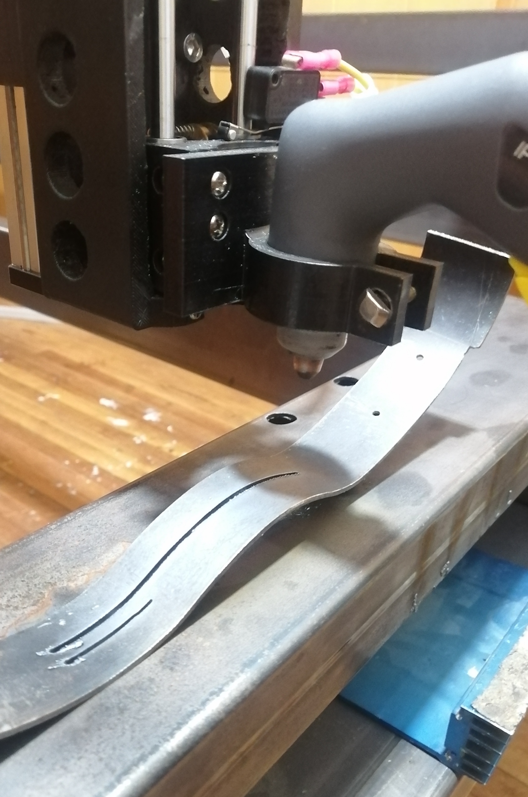

22 Sep 2021 16:12 #221354

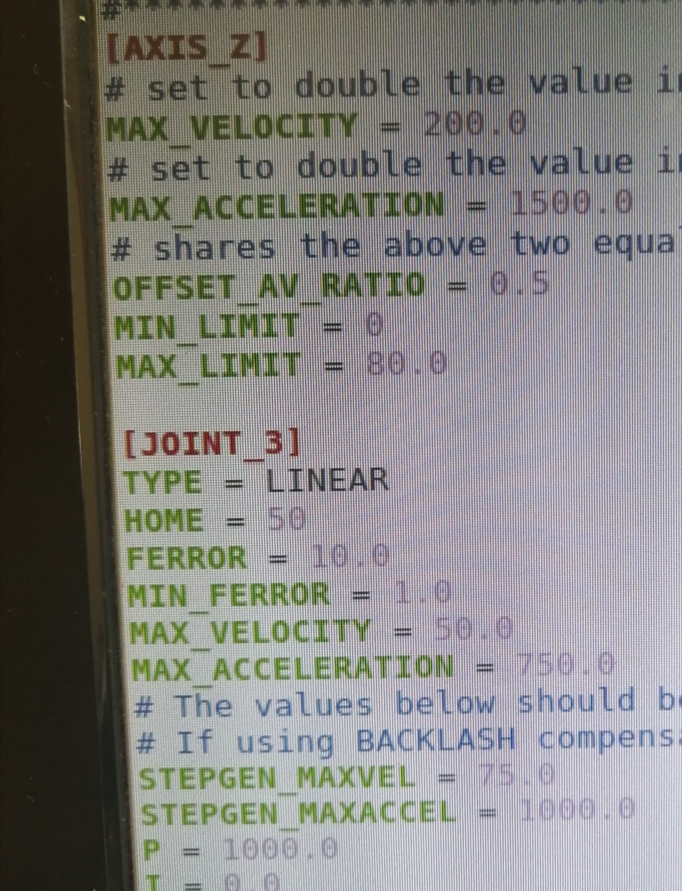

Thanks for you explicatiion, Can the PID values that I have in the joints affect something? In P I have 1000.

No, the stepgen PID values are correct.
The physical meaning of a P term of 1000
at a 1 ms servo thread rate is that any
stepgen accumulated position errors
are corrected at the next waypoint
(1 ms later)

The only thing I see is that plasmac.thc-feed-rate is 6000mm/min but the MAX_VEL in the joint is only 3000mm/min (50 x 60)
AXIS_Z MAX_VEL should be 100 (JOINT_# MAX_VEL * 2)
I don't know if that would cause an issue or not...

If the Z velocity and voltage were plotted in halscope,
that might give a clue to where the bottle-neck is.

Well guys after a night without sleep you see that the activation time of the thc was at 1.5s and it was too much for the slope of the metal that I wanted to cut and it did not allow to activate the thc I reduced it to 0.5 and it worked up to 2000 mm / min, thanks for his time I am still learning and calibrating my machine and reading a lot.
