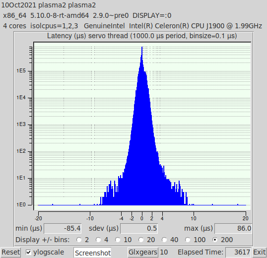

Well, this is a bit strange, I managed to build a RIP in another folder ~/linuxcnc-pla and when it loads, I get these messages despite both settings being in the ini file.
<commandline>:0: Pin 'ini.z.max_limit' does not exist
<commandline>:0: Pin 'ini.z.min_limit' does not exist
Just after that I get
hm2/hm2_7i76e.0: error finishing read! iter=3073
I know that shuts down Linuxcnc but I've never seen this before so here is the outputPing is
and I have set the coalescing. not sure if it was required or not but it did improve ping time marginally.
Latency is not an issue.
Is there something with QT or QTplasmac that needs reinstalling in the new RIP installation? It would seem the overrun is due to the software (QT/QTplasmac)

plasma2@plasma2:~$ ping 10.10.10.10
PING 10.10.10.10 (10.10.10.10) 56(84) bytes of data.
64 bytes from 10.10.10.10: icmp_seq=1 ttl=64 time=0.103 ms
64 bytes from 10.10.10.10: icmp_seq=2 ttl=64 time=0.106 ms
64 bytes from 10.10.10.10: icmp_seq=3 ttl=64 time=0.105 ms
64 bytes from 10.10.10.10: icmp_seq=4 ttl=64 time=0.103 msLatency is not an issue.

26 Oct 2021 02:57 #224319
by phillc54
Replied by phillc54 on topic Exiting conversational
What is the complete output in the terminal?
- Posts: 12156
- Thank you received: 4149
26 Oct 2021 04:02 #224323
I've still got the debs I made earlier so may revert to them ...
Replied by rodw on topic Exiting conversational
I'll let you know later. I accidentally deleted my linuxcnc folder. Have no idea how... I am rebuilding the linuxcnc-dev folder so I'll see how it goes...What is the complete output in the terminal?
- phillc54
- Posts: 5711
- Thank you received: 2100
26 Oct 2021 04:21 #224324
by phillc54
One possible reason for the error is that the directory link to qtplasmac in the config folder is pointing to the wrong place, eg you had a link for a package build when it should be a link for a rip build.
