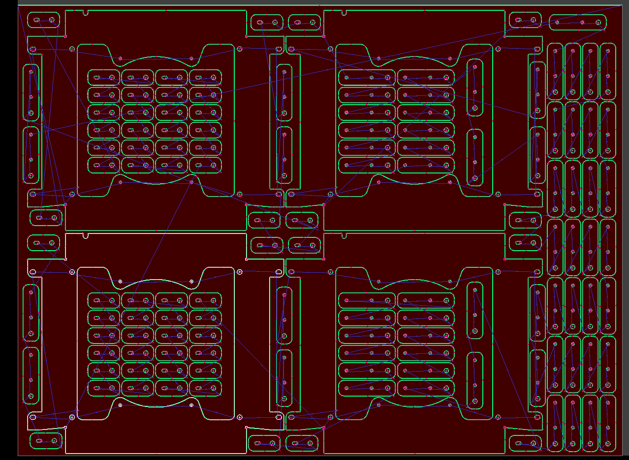

1200 x 900, I cut 2 of these and a smaller half a nest from a full sheet on my 1200 x 1200 table
thefabricator will outdo me here for sure but there are 528 pierces there.

rodw I am testing the sheetcam version 0.4 post processor for circles. I have it in mode 2, but in the gcode I don't see the speed of 60%, could you help me with that?

In my opinion, apart from the beginning and end of the cut, it is a problem of thermal expansion .. it seems that the sheet has moved a little.
regards Mauro

Thanks Mauro, I also thought the same because my plasma machine does not have a water table.

The plasmac gcode filter adds the hole processing commands when the file is opened so you won't see it unless you look in the gcode preview in the GUI.
