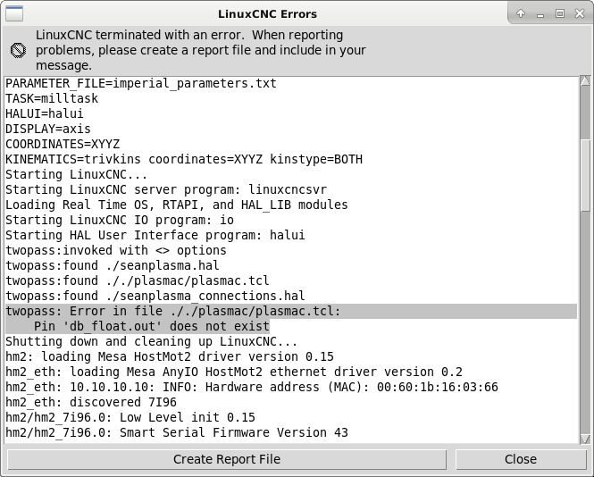

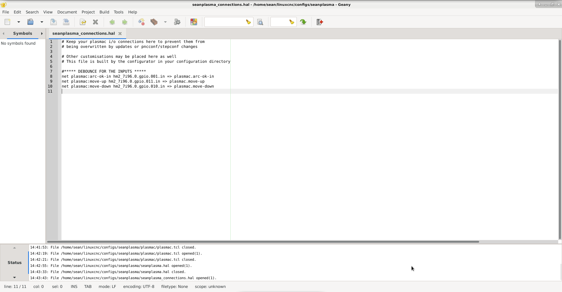

OK, so added in the SSR type pin for torch on (hm2_7i96.0.ssr.00.out-00) and changed the pin for float to hm2_7i96.0.gpio.009.in. The same error comes up.
There is no entry for the float in the connections.HAL file, can I just write in the float here? Why isn't the configurator doing this?

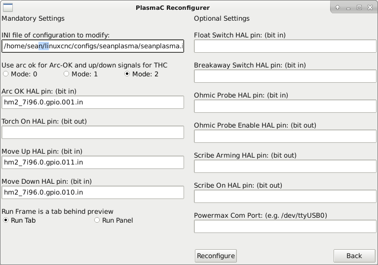

Then if I go back to the configurator to reconfigure, I get this:

The connections.hal file looks totally wrong, it should have content similar to below.
what version of LinuxCNC are you running?

09 Dec 2021 01:26 #228671
by phillc54
Replied by phillc54 on topic 7i96 Configuration Problems
It probably won't even load until that error is sorted.
The file contents I posted earlier is where that component is loaded.

- phillc54
- Posts: 5711
- Thank you received: 2100
09 Dec 2021 01:32 #228673
by phillc54
If you have a good base then I would be tempted to start a new PlasmaC config.

BTW, it wasn't anything you did, I see a problem in the configurator when it trys to reconfigure.
I will push a fix for it shortly, but it won't fix your config, you would be best to make a new one.
