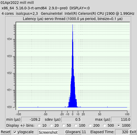

01 Apr 2022 09:59 #238979 by rodw
Gigabyte GB-BXBT-1900
mill@mill:~$ uname -v
#1 SMP PREEMPT_RT Debian 5.16.11-1 (2022-02-25)
mill@mill:~$
