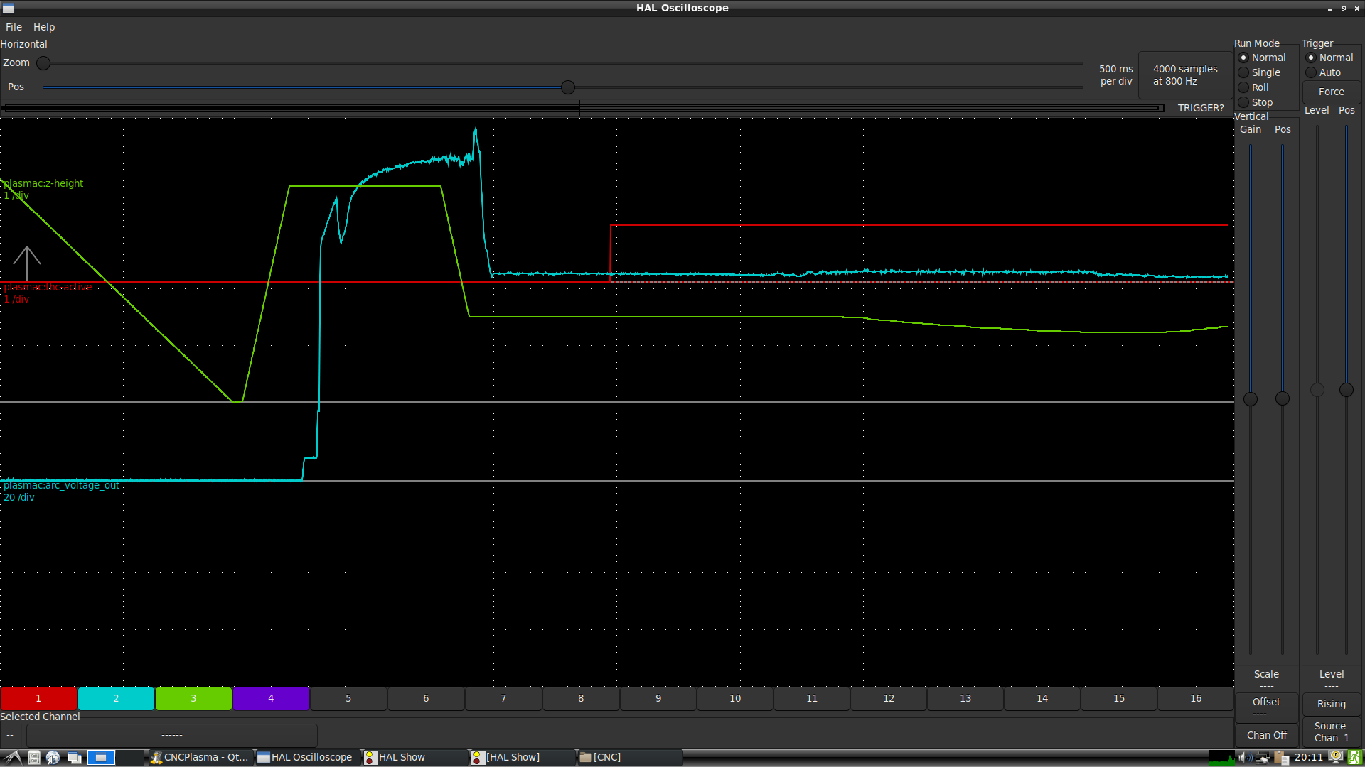

02 Sep 2022 11:17 - 02 Sep 2022 12:28 #250989 by rodw
Replied by rodw on topic QTPlasmaC issues / questions
Its great you are using halscope. I just leave it run all the time and stop it when I want to look at something.
Could you add plasmac.thc-active to your plot? This should show when the THC kicks in.
Also expand the torch voltage to amybe 20 or 30 per division so we see a bit more detail.
About 0.9 sec after the torch starts, the voltage drops and stays stable. This is not consistent with autosampling and more like you are specifying a target voltage. Autosampling should pick a point on the line  to optimise to.
I want to understand what is going on there.

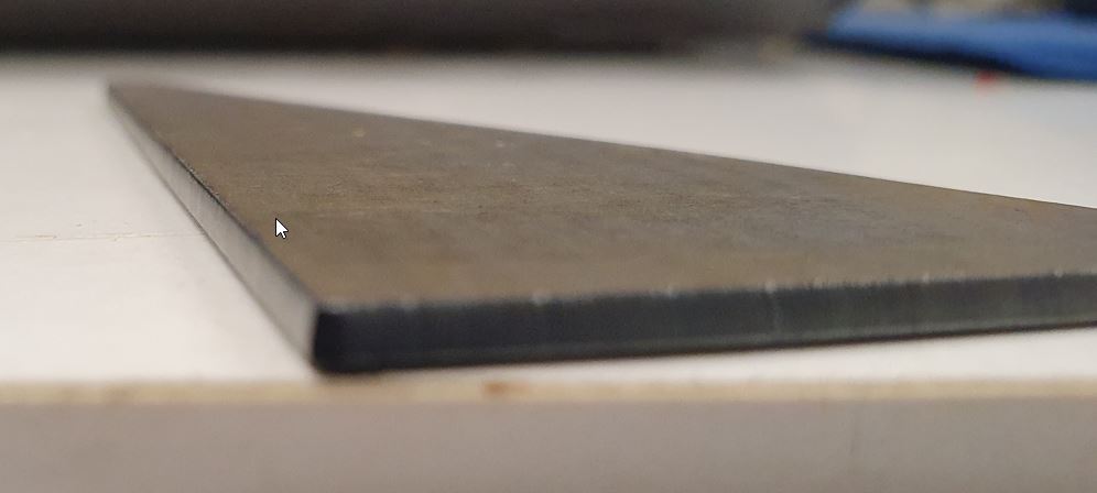

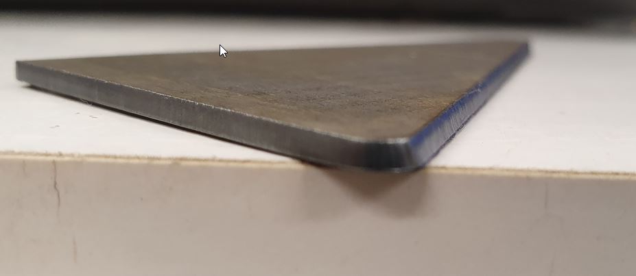

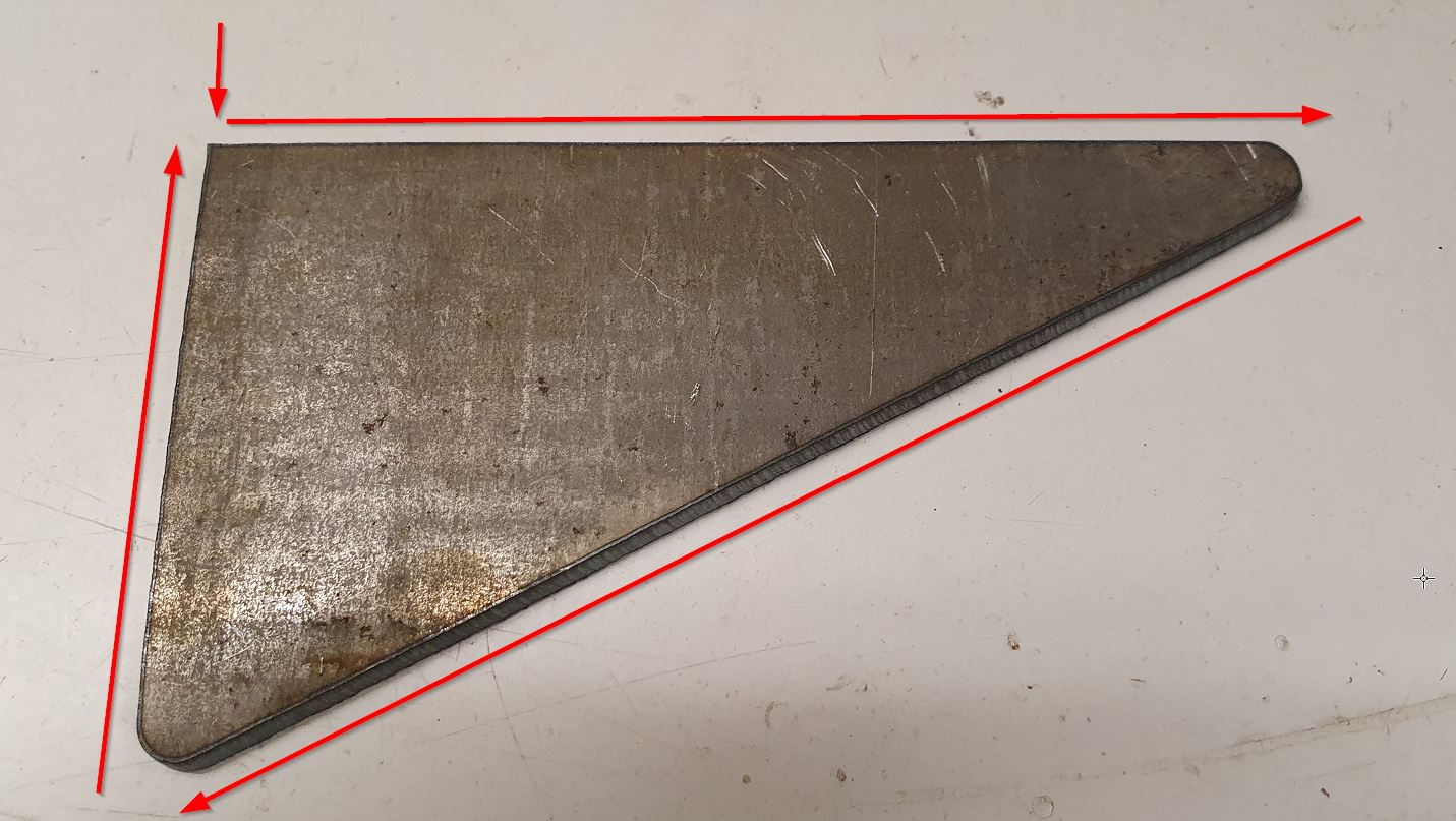

02 Sep 2022 17:31 - 02 Sep 2022 17:32 #251038 by JiiPee
Replied by JiiPee on topic QTPlasmaC issues / questions
Certainly!
The recording I made was with the ideas I had at the moment. Glad to get some new pointers from all of you guys, much appreciated!
File Attachment:
File Name: halscope_2..._45A.zip
File Size:16 KB
So I took the new recording. I am using the FineCut consumables and 2mm plate here. I have added the HalScope log too so I guess you could then see the actual data if you are interested. But it certainly looks very good to me and the THC goes active only after the voltage has stabilized.
I also attached the photos of the part I made and have been using to dial in the machine. Now that I did the X-axis alignment yesterday it seems to me that edges that are aligned in X-direction are looking pretty good! The diagonal and Y-direction edges however are preeeetty misaligned. anyway it seems the machine can indeed cut based on that one edge! :D
I starting to lean on what Tommylight said that it might be my not-so-stiff Z axis construction. The torch is pretty well held in X-axis direction but Y-direction has play when twisted even before the magnetic breakout plate breaks off.
