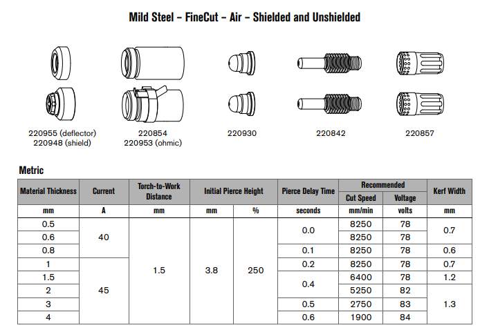

Heh it is a mystery to me as well. I mean it really doesn't seem that changing cut parameters make any meaningful difference at all. It really might be the torch alignment / sloppiness in the Z axis.I still wonder, 2mm thick and getting slopes????
First check the air supply, then nozzle/electrode and the ceramic ring, then the sealing o rings.
Might not be relevant, but most damages to the torch are from over tightening it when replacing consumables, do this several times to the torch and it is not usable anymore.

Your halscope looks fine.
What is the book voltage for your cut and how does it compare with the plot value?
I make it about 65 volts which seems low.
I don't use a Hypertherm but I thought fine cut was generally used for thin material, eg HVAC stuff and most would use normal coonsumables for 2mm. Maybe Clive has some feedback there.
Are you using the ArcOK signal from the Hypertherm? Eg Mode 1
The spike before the voltage peaks could confuse other modes (eg synthesised arcOK) MOde 0
Are we just chasing the cut bevel issue now?

My vertical alignment is quite bad on that scope-view. To me it seems though that it is a bit higher than 68v. I will check tomorrow from the Halscope directly. The table value is 78V if I remember correctly and the 2mm sheet is the lowest value the normal consumable table goes. I thought trying out with fineCut stuff as I had them also around. It really makes great quality cut where it doesnt bevel. No dross and extremely fine edge
And yes I am reading the Arc Ok signal and use that as the start trigger for the torch movement.

Yeah basically bevel issue is the last remaining bigger thing now. I think I have gotten around the other stuff thanks to all you guys! Bevel with thinner materials is noticeably worse than with thick. Thick stuff like 5mm and 8mm has it way better but not without problems there either. I really think that my next course of action is to rebuild the Z-axis from better parts and make it stiffer to the point that there is no visible play in the torch even if twisted by hand.Your halscope looks fine.
