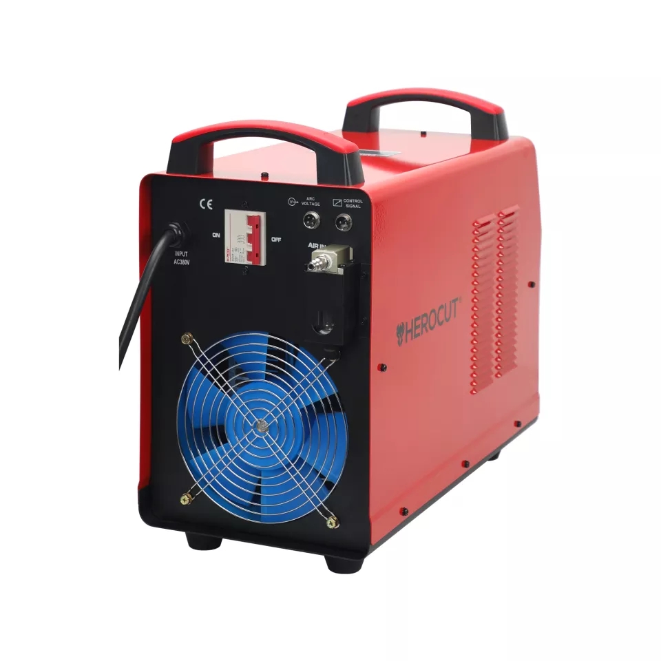

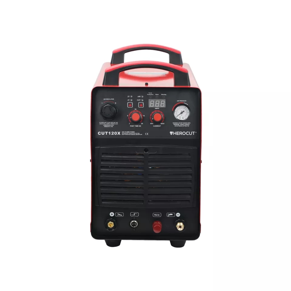

Well have a question in line with the subject here. I have a chinese Hynade cut60DN plasma like this one with the 1:1 ratio arc voltage stated for the 2 pin connector on the machine. Im having some problems with it. Also using a 7i96s with the thcad-10. I have been following another build and they had stated they had a 2.4m ohm resistor on the - pin to the thcad-10 arc voltage input. So i did the same thing figuring it would work the same way for me as well but its not. I was only getting .112 of a volt at my encoder a input pins on the 7i96s board while cutting with the plasma. So after more testing i found out that im only getting between 110 and 130 volts with my meter hooked to the pins on the back of the machine without any resistor in line at all while cutting .125 steel. So does that mean it isn't 1:1 but maybe 50:1 or something else? I cant get any voltage out of it at all without a arc going for at least 5 or 6 seconds as well. Any ideas if there is a way to tell if i open the case on the plasma to say for sure that's what is going on? Any help would be greatly appreciated!!
- Posts: 18105
- Thank you received: 5328
26 Mar 2023 22:03 #267565
Replied by PCW on topic Mesa THCAD-10
110 to 130 V when cutting most likely means the output is 1:1
Not being present at Arc start is a bit mysterious

So do you think a resistor is needed? I was thinking i would need to be inputting 100 to 200 volts for the thcad-10 to output the 0-10 volts?
