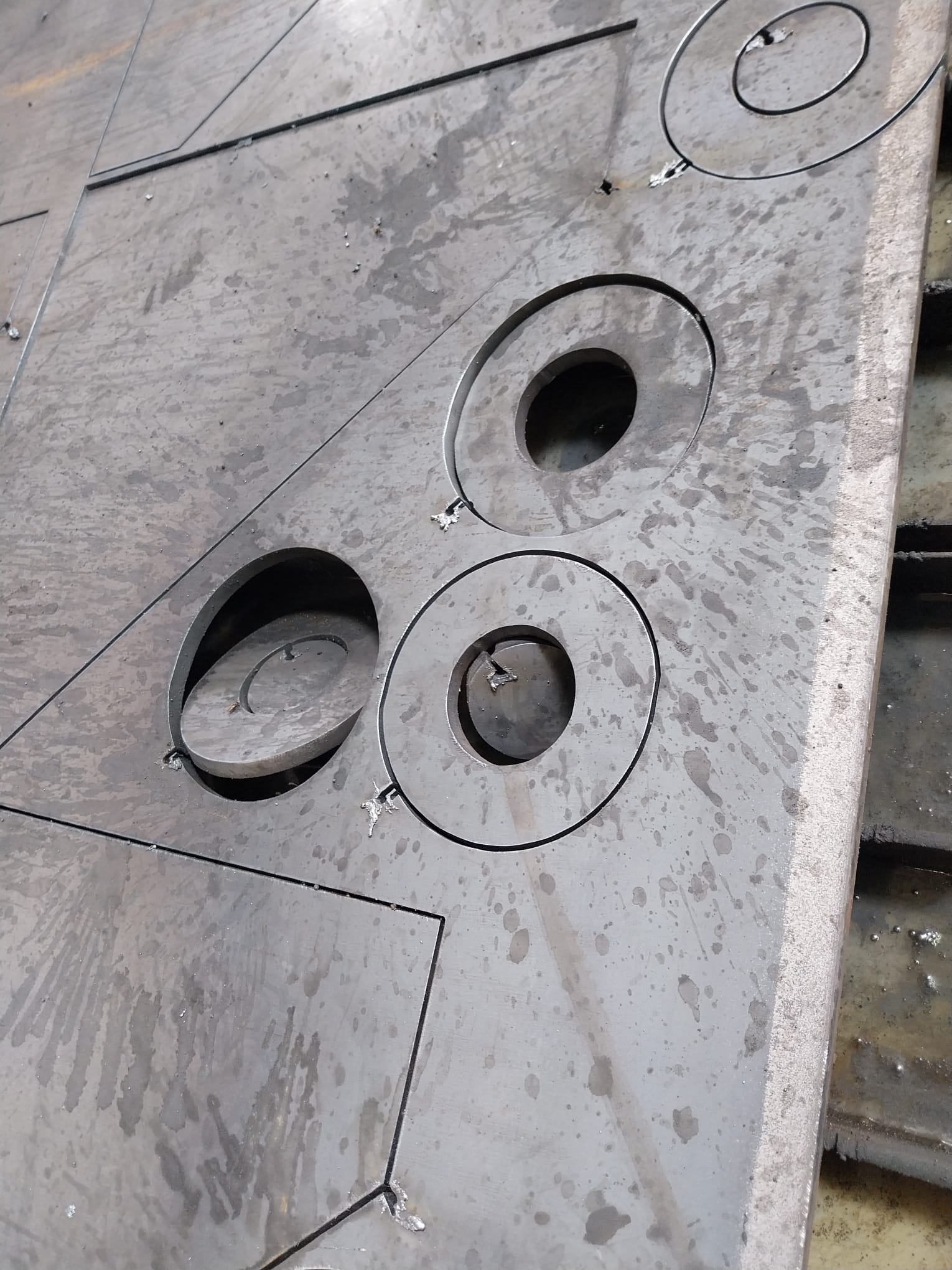

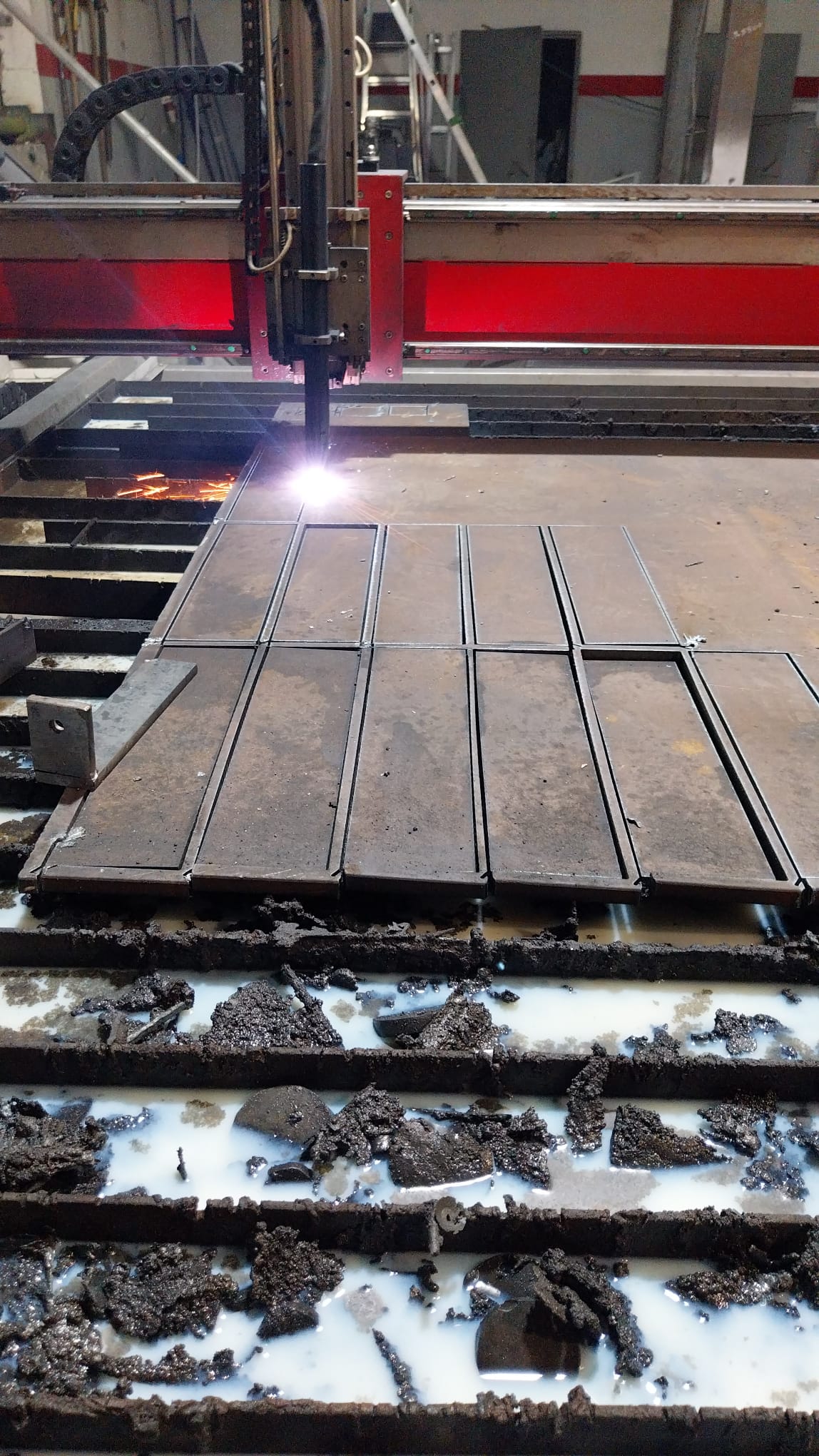

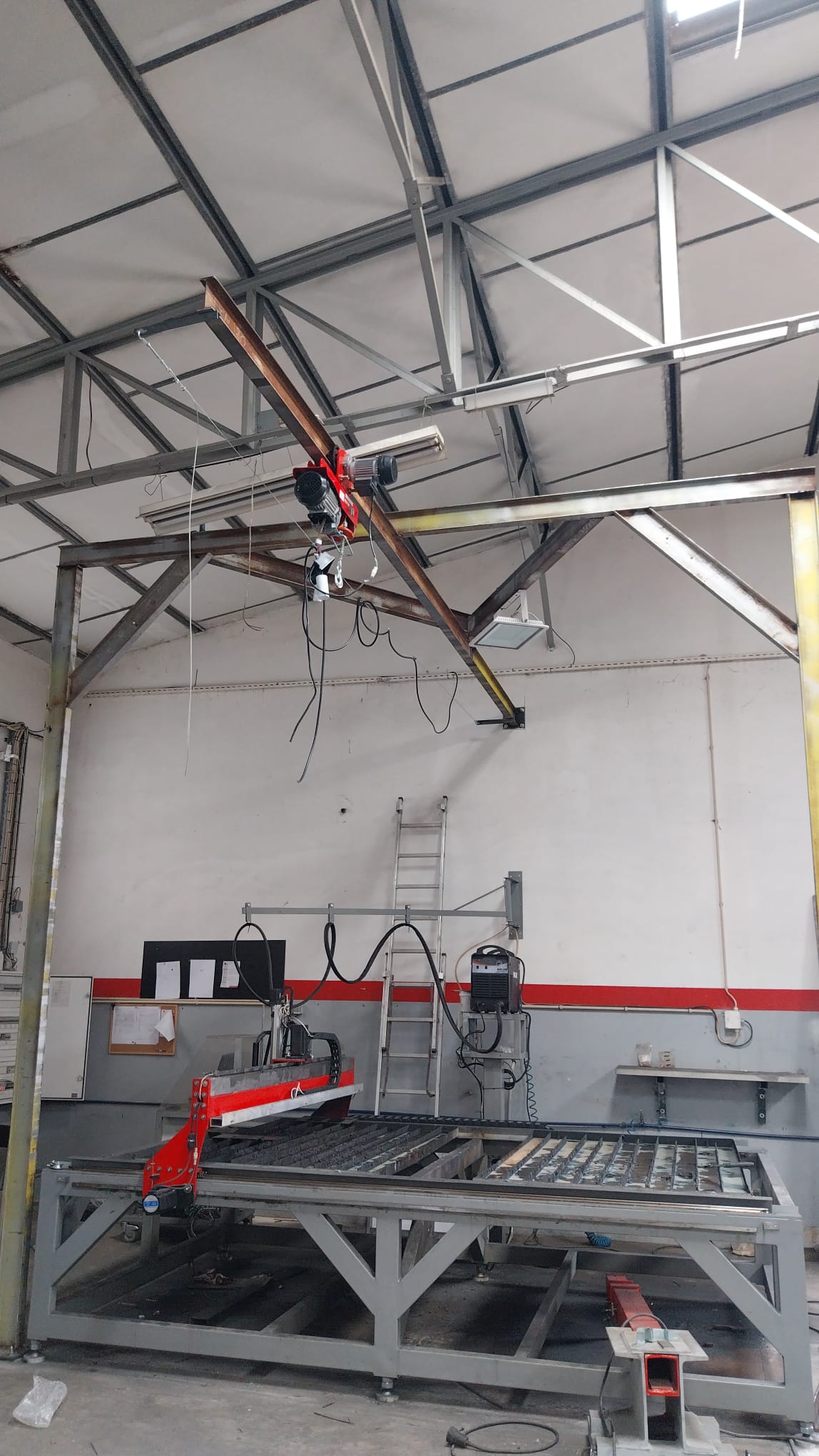

Here some examples of plasma cnc working. Don´t know how put videos, i show you some images.
Machine was made here in Portugal! by us, with support of you in this forum and linuxcnc.org and youtube...
I think this machine in last 3 months, have cutted almost 6 tons
Very thanks
Very thanks
