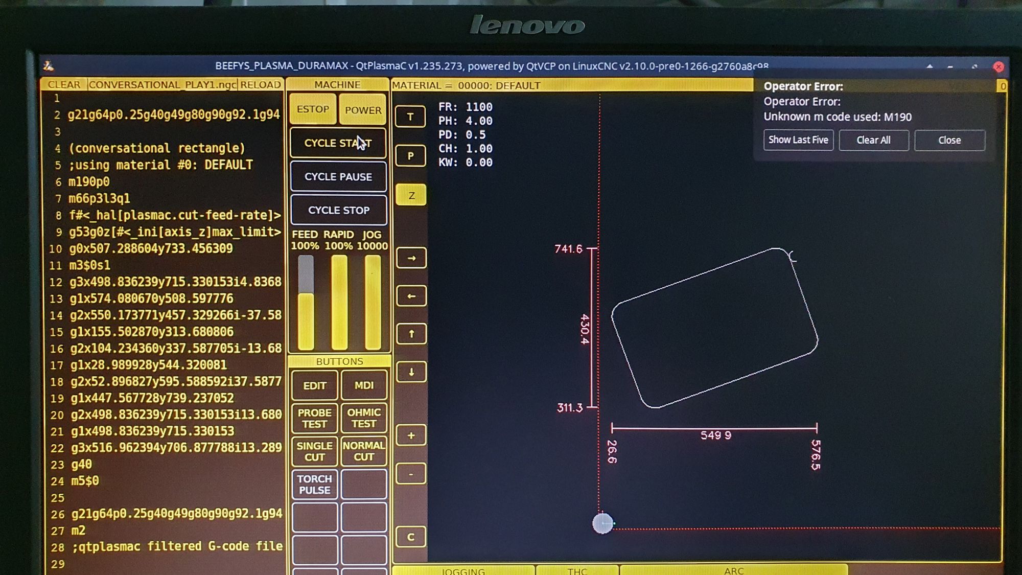

Tried the conversational for the very first time.
When I tried to run the generated code it said M190 not recognised. Gcode and screenshot below:

Have you checked if the file 'M190' is marked as 'executable'? (It is not marked as executable in your compressed folder)
To check:
Right click on file 'M190' -> 'Properties' -> choose tab 'Permissions' -> 'Allow executing file as program' needs to be activated (checked)

I'm guessing that will indeed be the problem.
I found the docs for "user-defined m-codes" for which M190 is one of them, and it listed the very problem I'm having. Quote:
The error Unknown M code used denotes one of the following
The specified User Defined Command does not exist
The file is not an executable file
The file name has an extension
The file name does not follow this format Mnnn where nnn = 100 through 199
The file name used a lower case M
And I think all the other conditions are good.
I'll report back when I've looked into the executable status of the file.

Yep that was it, all working now. One little tick box to make the file executable.
Thanks very much for the help guys.
