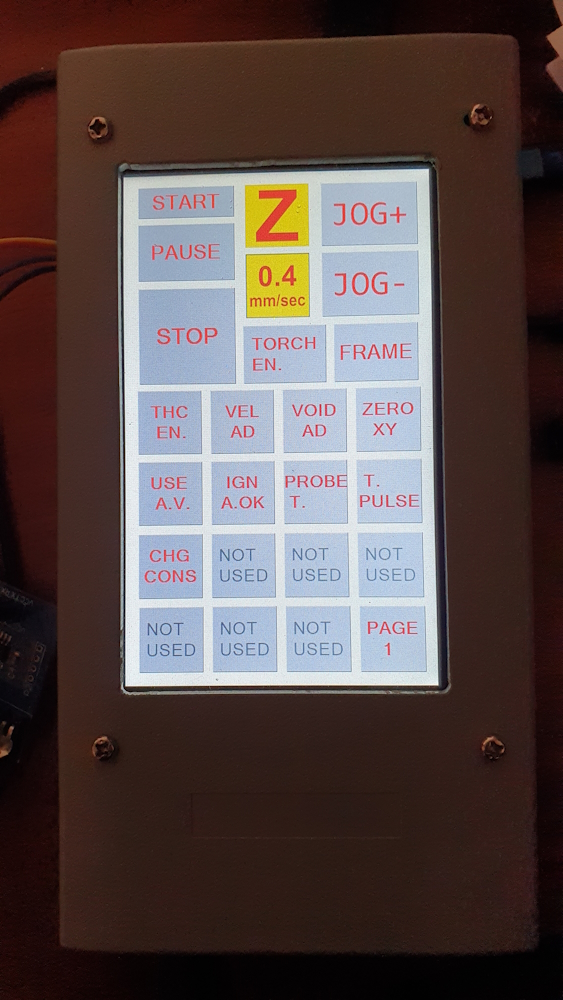

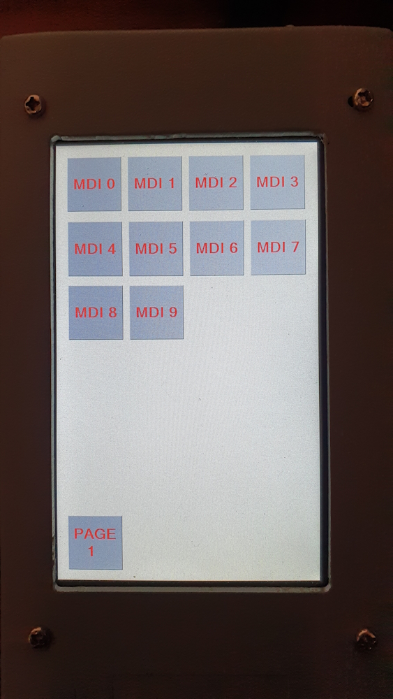

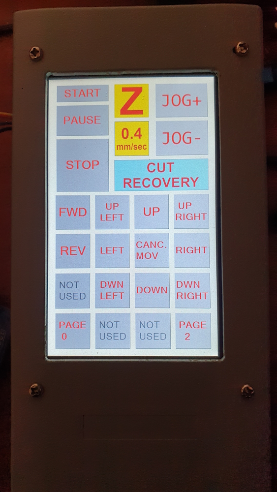

- beefy
- Posts: 227
- Thank you received: 58
11 Aug 2023 23:09 - 11 Aug 2023 23:11 #277680
by beefy
Replied by beefy on topic M190 not recognised
Hey Phil,
I woke up early and used the time to finish the coding in the microcontroller (that doesn't mean it works LOL) and the touchscreen.
I've attached photos of the 3 pages of the touchscreen.
Seeing as you're a technical guy I'll give you a brief description of it's workings.
On page zero you've got the Cycle Start, Pause/Resume, Stop, and a bunch of others that trigger the Qtplasmac external hal pins. Plus the set of buttons related to jogging.
The touchscreen buttons only allow a total of 8 characters of text, including spaces, so the decriptions are rather shortened. One day (maybe) I might get around to prettying things up with fancy images on the buttons that change when the button is pressed. Just going for functionality at present.
Page 1, at the top, is a copy of Page 0, but underneath you have all the Cut Recovery buttons.
Page 2 is just 10 MDI_COMMAND buttons. I have 10 "blank" MDI_COMMAND="" in the ini file and associated hal pin connections in the hal file, so all I have to do is put any required code after the MDI_COMMAND= in the ini file and the pendant button press should execute it.
All the touchscreen does is send command bytes to a microcontroller, which in turn pulses 6 outputs that "connect" to my custom 6 input, 64 output DEMUX component, thus pulsing one of the 64 outputs for a set time interval, unless it's a Cut Recovery FWD/REV which is continuously on while the button is pressed.
The 6 microcontroller outputs get to hal via the 7i96 P1 expansion connector.
The DEMUX component outputs connect to Qtplasmac external hal pins, as well as the hal MDI pins.
The other thing the microcontroller does is act as an encoder emulator and 2 outputs represent the A and B quadrature signals, which feed into the P1 expansion connector on the 7i96. A single button is repeatedly pressed to cycle through XYZ jog-enable, and the jog speed button works the same to select a jog speed. When the Jog+ or Jog- button is pressed the emulated encoder signals are output at a rate determined by the jog speed selection.
Everything I'd programmed before this point worked, the Cycle Start, Pause/Resume, Stop, Torch Enable, THC Enable, and Touch Off XY to Zero, so if I haven't stuffed up in my coding today, I'm expecting all the other buttons will work too.
Once I've confirmed all is working with a basic short TTL level serial connection, I'll install TTL to RS422 converter PCBs at each end so I have noise proof differential signals for transmission over the long wire.
I normally just use a cheap twisted pair 8 core ethernet cable for that.
It's still a pig though having a wired connection. I'm wondering if down the track I can find an off the shelf wireless transceiver pair that I can put in place of the wired connection. Will have to be fairly noise immune though being in a plasma environment.

- phillc54
- Posts: 5711
- Thank you received: 2100
12 Aug 2023 00:01 #277687
by phillc54
Replied by phillc54 on topic M190 not recognised
That is pretty cool Keith, I like it...
Have you thought of using an MPG for jogging?
