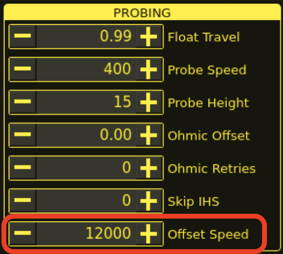

my build is running nicely. I set up QtPlasmac with offset probing and a pneumatic probe which fires down and also has airflow through the pneumatic probe which pretty much eliminates the problems i had with water on my material offsetting the ohmic probe.
Now since my setup is running nicely im all into optimizing cut speed which brings me to my question. The X ans Y offset of the pneumatic probe is quite large (Like 5cm from the Cutting head) now since i usually have many centerpunches and pierce movements in my work offset probing takes quite a chunk of the cut time since it moves to the offset position very slowly... I optimized the Z axis movement/Position already but the X/Y movement to and from the Probe Position is very slow which brings me to a Probe time of approx 8 seconds which is a lot if i have a file where i have to centerpunch like 200 holes.
I cannot find the setting for the offset probe movement speed can someone please point me in the right direction (which parameter/speed setting in the ini file defines this movement?) i checked the documentation but i cant seem to find anything. I know i can move much faster since all x and y motors have planetary gearboxes installed which did wonders to my max accel and velocity i hope someone knows how to speed up the offset probing motion... like 26 minutes of probing in a file which cuts in like 40 minutes literally drives me insane. I saw some guys probing at very high speeds here my machine crawls like a snail in comparison please enlighten me.

I do know it’s a function of setup speed. What is your setup speed set to?

As Greg said, the X/Y offset probe move is calculated from the Setup Speed. We haven't had any feedback on this function and I wasn't sure anyone was even using it.
If using Setup Speed does not offer enough flexibility then we could add an additional parameter to allow the setting of the offset probing X/Y moves separately.

Ok so i just checked. Offset movement roughly equals the setup speed a bit slower i think. I will try to optimize the probe height/movement some more and create another mount for my probe to move it another few cm closer to the head this should cut down the probing time by a few seconds.
Also ill probably ramp up my setup speeds which i havent done since i installed the planetary gearboxes.
Would it be a lot of work to put in a seperate offset probing moving speed parameter?
I would love to have that.

Master branch now has adjustable X/Y axes velocity for offset probing. The additional parameter in the probing frame is labelled Offset Speed and will only display if valid probe offsets appear in the preferences file. The maximum velocity is limited to the lesser of the X available velocity, the Y available velocity, and the ini file [TRAJ]MAXIMUM_LINEAR_VELOCITY parameter. The default is 80% of the maximum.
