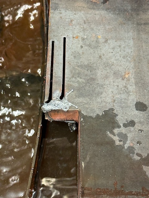

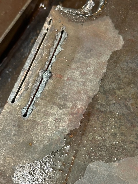

Well team, time for an update. Have been working on this a little and refined/resolved some key bugs. Still need to solve the PP for sheetcam, not 100% happy with that and how the M words are playing.
Anyway, the meat is how things perform. The test:
Cutskill 60 - this is a Cigweld branded machine under the ESAB group. It has been enhanced for THC and remote on/off.
16mm mild steel.
PTM80 torch running at 60amps and a 1.1mm unshielded tip.
The test cut (number two as someone insisted it needed to not blow out the side of the metal to prove it pierces)
You can clearly see when the pierce happens. It also behaves just as designed regarding the means of evacuating all the excess material as part of the pierce process.
To be clear, this is a MOVING pierce (ramp style) and it creates the needed trench to cause all the molten material to be evacuated.
Cheers - James.

07 Nov 2023 08:28 #284757
Replied by rodw on topic Feature Request: ramp piercing (aka moving piercing)
Looks great Joco. I seem to remember some one saying this will never work....
Great to know its allowing you to easilly pierce material thicker than what a machine of that amperage usually can achieve without destroying consumables...
My take twas that it ramped in during the leadin, not circular motion.
That will never pierce through thick material as it will consistently have to pierce the same amount of material.

07 Nov 2023 13:22 #284771
Thank you, both.
Replied by tommylight on topic Feature Request: ramp piercing (aka moving piercing)
I stand corrected!Looks great Joco. I seem to remember some one saying this will never work....
Thank you, both.
