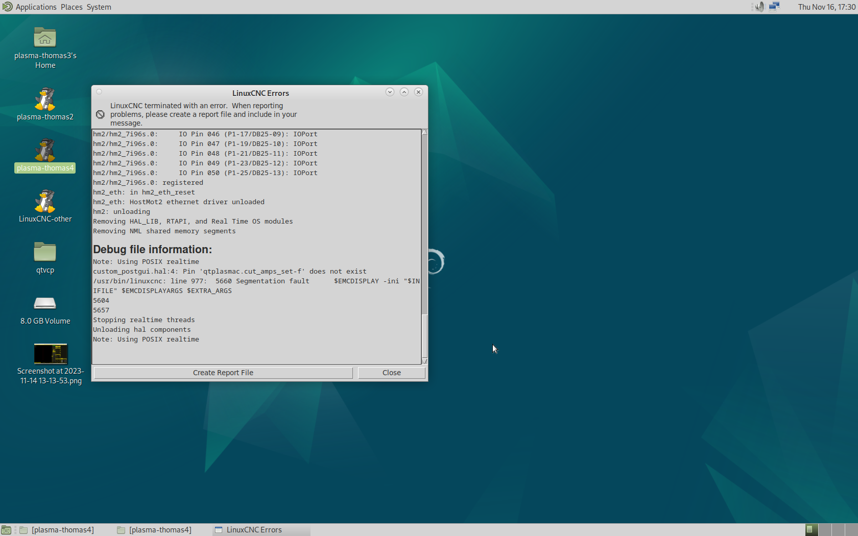

Hallo phillc54
Oh....
now we have an error !!
see attachment
I didn't have any errors before
king regarde and thank's
juergen

- phillc54
- Posts: 5711
- Thank you received: 2100
15 Nov 2023 22:28 #285549
by phillc54
Replied by phillc54 on topic Button erstellt und er soll auch schalten Button created and he should also swit
Oh, that pin does not exist in the latest code. I have changed the names to be similar to your original names. The pin for the cut amps display is already linked in the latest code.

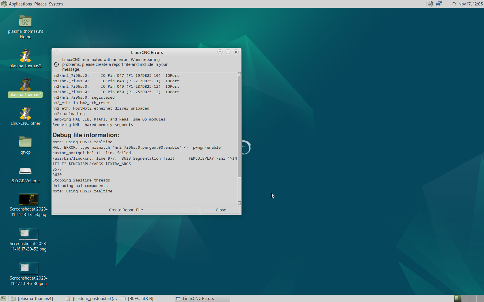

I swapped the custom_postgui.hal for the first oneget the error
please refer Attachment
Ok

Can you try this one:

- phillc54
- Posts: 5711
16 Nov 2023 11:20 #285601
by phillc54
Oops...
In qtplasmac_custom.py change line 86 to:'

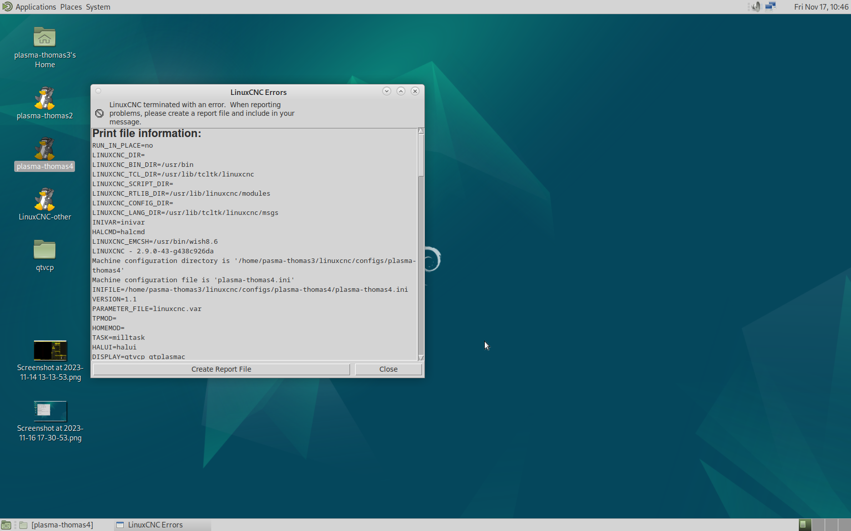

self.pwmEnablePin = self.h.newpin('cut_amps_pwmgn', hal.HAL_BIT, hal.HAL_OUT)Please Log in or Create an account to join the conversation.
- Plasmanfm
- Posts: 130
- Thank you received: 22
16 Nov 2023 11:46 #285605
by Plasmanfm
Replied by Plasmanfm on topic Button erstellt und er soll auch schalten Button created and he should also swit
Hallo phillc54
Switching on the pwmgn works now
But I have the value on the display
is 0! I can't change the value using + or minus
Juergen
