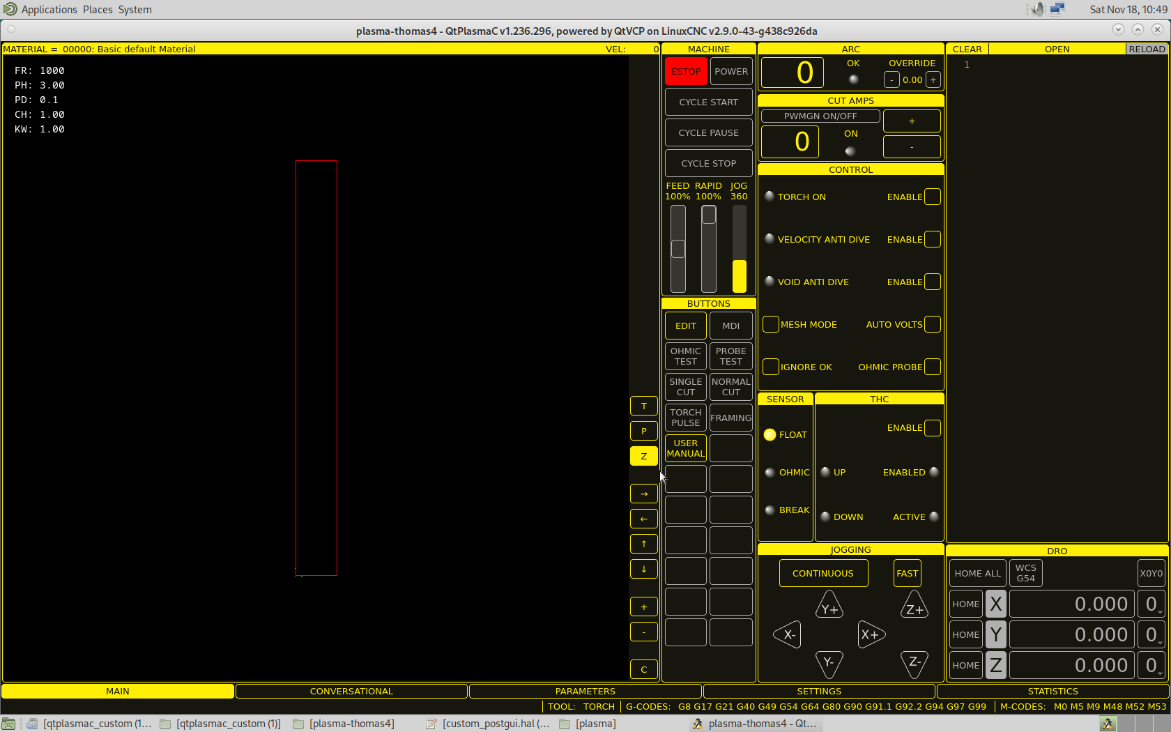

Does the value of cut amps in the parameters page change when you use the + and - buttons in the main page?
- Plasmanfm
- Posts: 130
- Thank you received: 22
16 Nov 2023 12:18 - 16 Nov 2023 12:21 #285609
by Plasmanfm
Replied by Plasmanfm on topic Button erstellt und er soll auch schalten Button created and he should also swit
No
In the hall-show cut_amps_2 value and cut_amp-f 50 and kan set wiht + or -
Last edit: 16 Nov 2023 12:21 by Plasmanfm.

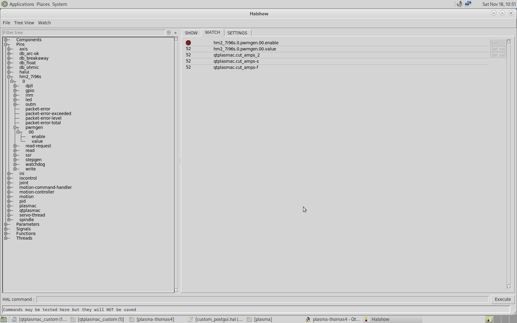

16 Nov 2023 17:53 #285639
by Plasmanfm
Hallo phillc 54
What I noticed in the Hall show is there is a pin qtplasmac cut_amps_2-2
it is a pin with not Value
king regarde and thank´s
Juergen

17 Nov 2023 10:03 - 17 Nov 2023 10:40 #285716
by Plasmanfm
Hallo phillc54
OK, we now have the values on the Pwmgn adjustable with + and -
the value is missing from the display
please refer Attachments
king regarde and thank's
Juergen
Juergen

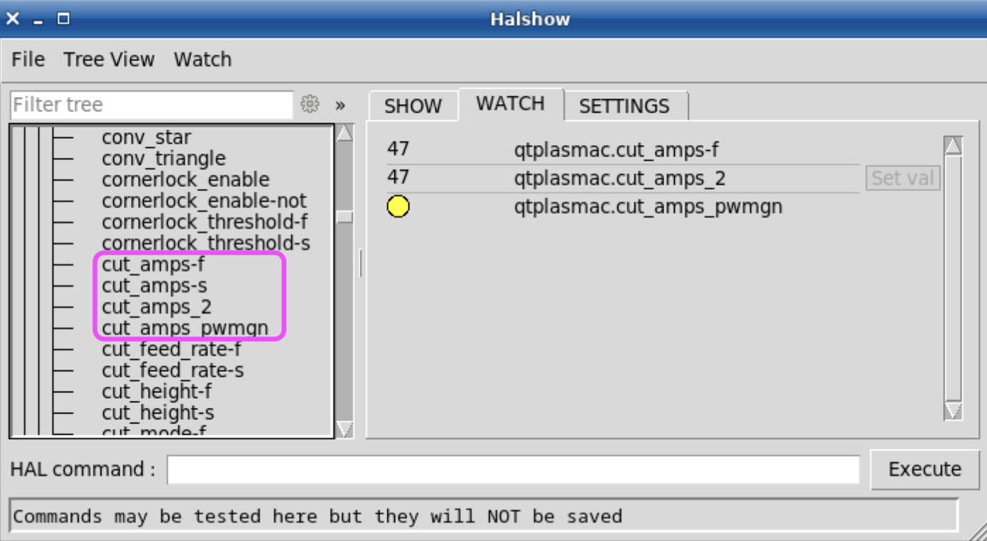

17 Nov 2023 10:50 #285724
by Plasmanfm
Hallo plillc54
the pin qtplasmac cut_amps_2-2 is the Display
when I'm on the Hall show pin qtplasmac cut_amps_2-2
"set" the value I have the value in the display
the value for the pin qtplasmac cut_amps_2-2 would have to be passed
Juergen

17 Nov 2023 10:59 #285728
by phillc54
Replied by phillc54 on topic Button erstellt und er soll auch schalten Button created and he should also swit
There is no pin named cut_amps_2-2, there is a pin named cut_amps_2 and it is connected in the custom_postgui.hal file that was in my last post.
net qtplasmac:cut_amps qtplasmac.cut_amps-f => qtplasmac.cut_amps_2 hm2_7i96s.0.pwmgen.00.valuePlease Log in or Create an account to join the conversation.

17 Nov 2023 11:09 #285730
by Plasmanfm
Hallo plillc54
it looks like it's working now
I have in the custom_postgui.hal that insert : net qtplasmac:cut_amps qtplasmac.cut_amps-f => qtplasmac.cut_amps_2-2
Yesterday I had a suspicion that it was the display...
0 value in display 0
OK, I'll do a few tests now
