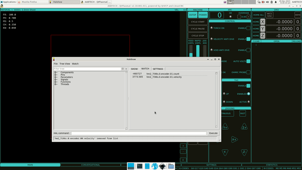

The video above shows the encoder is counting in Hal show but now is not counting.

Encoder velocity ?
THCAD when wired correctly counts all the time, yours is idle on last picture.
Last edit: 05 Dec 2023 01:22 by tommylight. Reason: more info

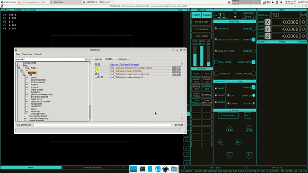

Replied by tommylight on topic Having problems with my THCAD-10
Notice the voltage in the GUI, now it shows 0 as it should.
Try cutting something ....

Replied by aabtech on topic Having problems with my THCAD-10
now the THC is working correctly. thanks very much tommy.
