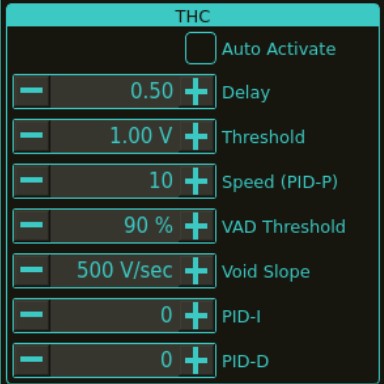

Having problems with my THCAD-10

06 Dec 2023 01:12 - 06 Dec 2023 01:15 #287325
by aabtech
Replied by aabtech on topic Having problems with my THCAD-10
Last edit: 06 Dec 2023 01:15 by aabtech.

06 Dec 2023 10:27 #287345
Replied by tommylight on topic Having problems with my THCAD-10
Set VAD to 60 or 65, save.
The rest should be good as is, so do not touch those.
