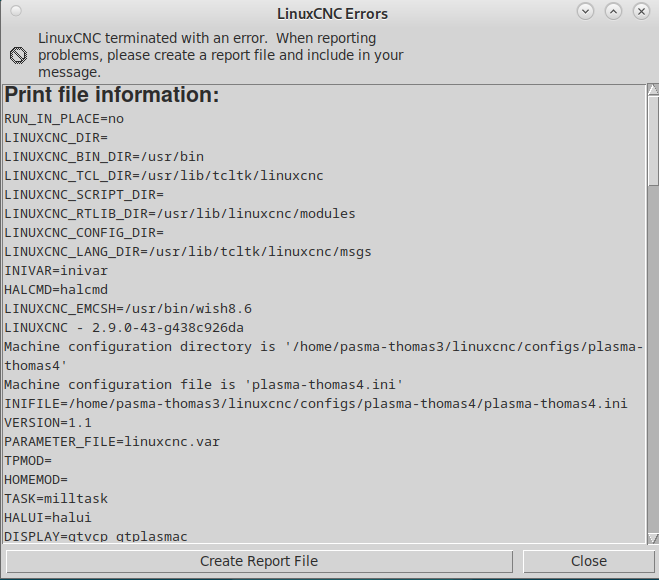

Hallo phillc54OK...first we had this error
please refer attachments
then I looked at the hall again here !!and found this:net estop-ext  elatch.fault-in
net estop-reset iocontrol.0.user-request-enable => elatch.reset
net estop-out  elatch.ok-out          => iocontrol.0.emc-enable-in
# comment out the next line if the estop button is for estop reset only
net estop-set  iocontrol.0.user-enable-out   => elatch.ok-in
I put it in with paste and copy !In the program you don't just see these "A" here
Now I removed all the empty fields and made them new
now it seems to be working
I'll test it first
king regarde
and thank´sJuergen
