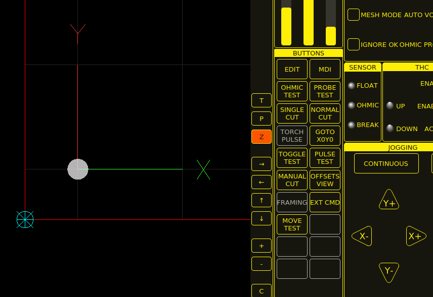

05 Jun 2024 23:32 - 05 Jun 2024 23:39 #302423 by snowgoer540
Replied by snowgoer540 on topic Random Questions on setup
Also is there a way to change the Velocity position and Size on the screen?
Position - not easily (it's an open source project so there's usually always a way)
Size - yes. Follow these directions: linuxcnc.org/docs/devel/html/plasma/qtpl...#_add_a_custom_style
inside of qtplasmac_custom.qss, add these lines:
#velocity_label {
font: 14pt
#velocity_show {
font: 14pt
That will change the size of the VEL: label and the indicator to 14pt font, in this case.
Oh and switch the Buttons on the Jog like switch + and -
Again, no, not easily. but why would you want to? The X and Y indicators in the preview point toward X and Y positive. The GUI buttons follow as pictured below:
To do anything else would be ... wrong.
Maybe you are expecting the table to behave differently given the orientation of your control console. In that case, .ini file changes are in order....
