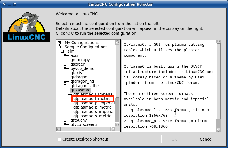

26 Aug 2024 03:49 #308648
by phillc54
Replied by phillc54 on topic #<holes> = 3 - Unexpected behaviour

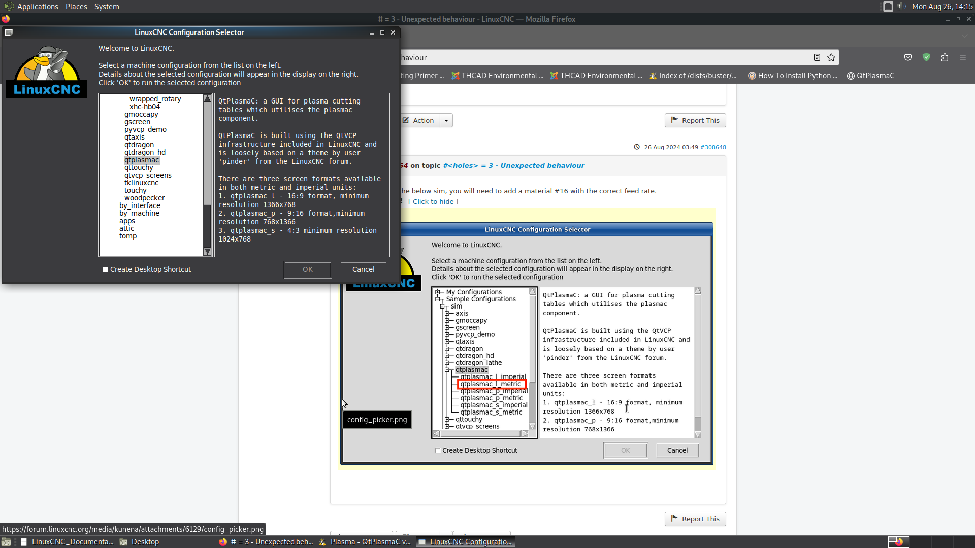

Hi Phil,
I can only get this far, see screenshot attached. No menu opening up to pick a sim configuration ?

Wow, I have not seen anything like that before, I have no clue...
Try this from a terminal:
linuxcnc /usr/share/doc/linuxcnc/examples/sample-configs/sim/qtplasmac/qtplasmac_l_metric.iniPlease Log in or Create an account to join the conversation.

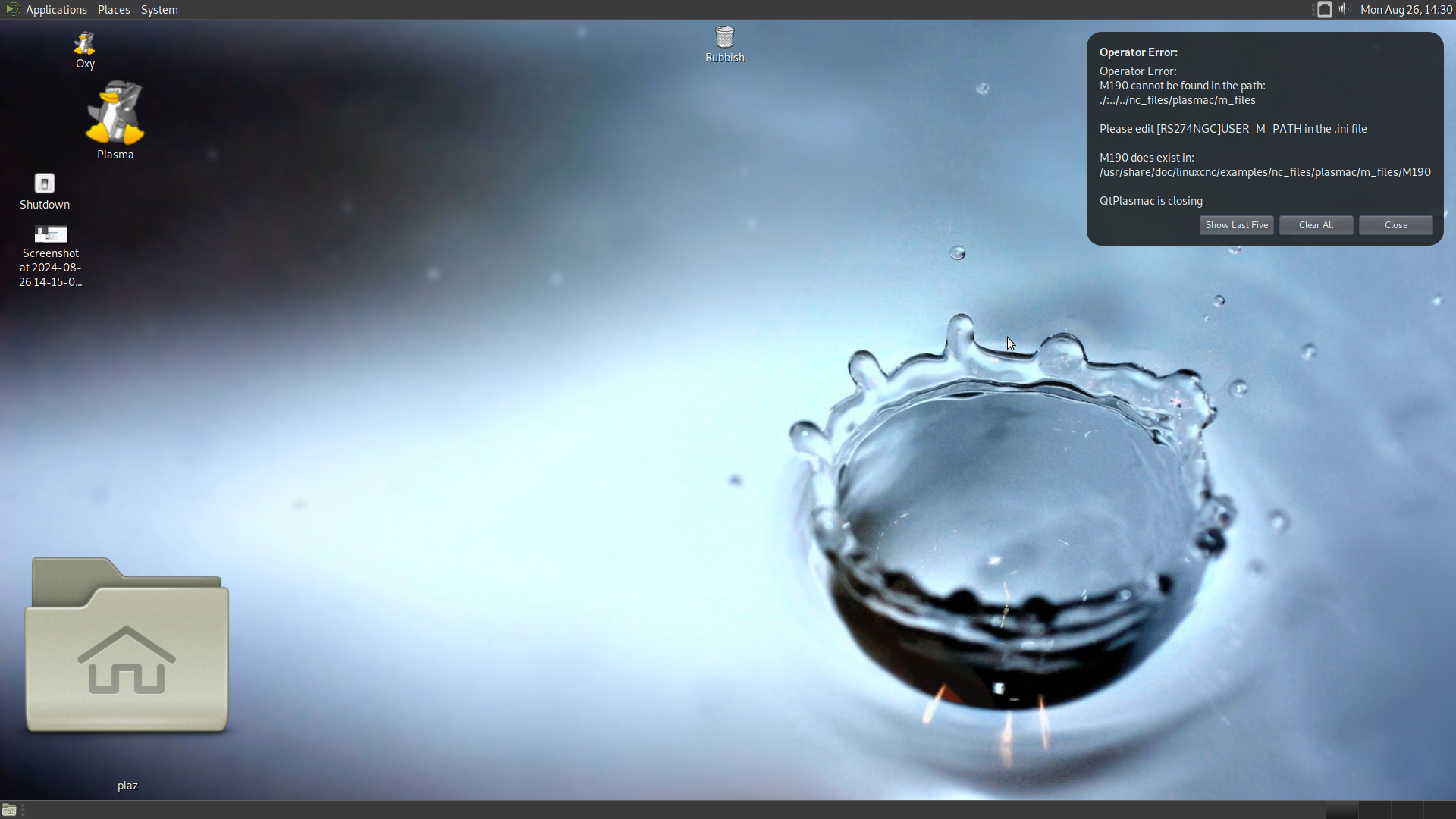

Somehow I have a sim configuration, but it throws an error on opening, see image attached. Sorry, I have no experience with sim configurations at all

Interestingly I made a sim from your config and it showed the same error but it did actually work. It also worked correctly on your gcode file.
Is it possible that your screen is "laggy" and does not update quick enough?

Hi Phil,
It seems having to do with missing "M190" and this section in the ini file :
[RS274NGC]
RS274NGC_STARTUP_CODE = G21 G40 G49 G80 G90 G92.1 G94 G97 M52P1
PARAMETER_FILE = metric_parameters.txt
SUBROUTINE_PATH = ./:../../nc_files
USER_M_PATH = ./:../../nc_files/plasmac/m_files
But that's as far as I can get ?
[RS274NGC]
