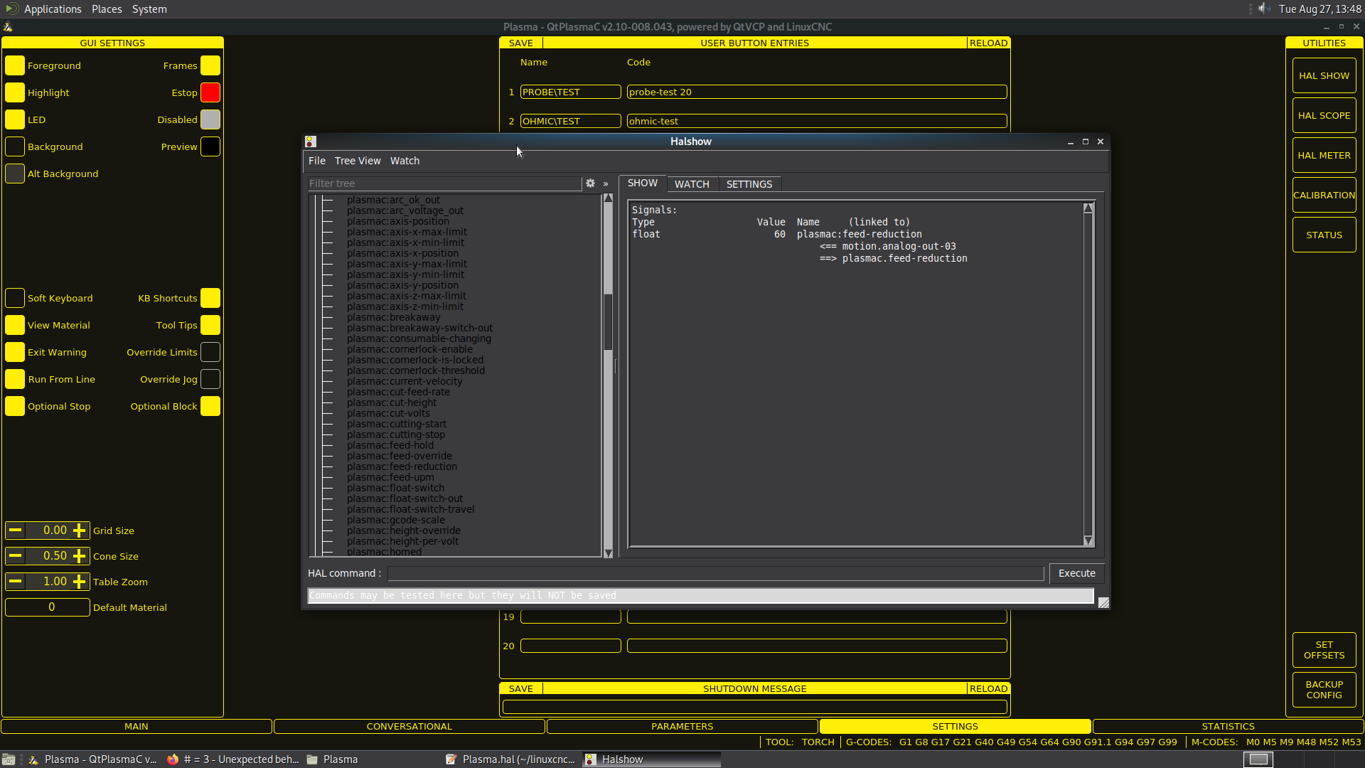

Hi Phil,
Same result on the motion.analog-out-03 pin.
Cheers, Peter
Cheers, Peter

Hi Phil,
Thank you. I checked the HAL pins and it looks like the feed reduction pin is connected to the motion pin. I will bring it up in advanced configuration, hopefully that gives us some clarity.
Love your work !
Cheers, Peter

I am probably barking up the wrong tree but could you try with the following lines disabled in their respective files:
Plasma.ini: HALFILE = plasma_gamepad.hal
Plasma.hal: loadusr -W hal_input -KRAL GamepadPlease Log in or Create an account to join the conversation.

I did some digging into this today. I didn't see the issue on my system either, but I noticed I am up to date with all of the commits on master (QtPlasmaC version 008.048), whereas you are on 008.043. That is from May 4, 2024. I did some digging in to the commit history, as I vaguely remembered seeing something involving Motion, and I found this commit:
github.com/LinuxCNC/linuxcnc/commit/6598...13e27e03e792dc838c86
in the commit description, it solves some M67 issues. Here is the issue it claims to have fixed:
github.com/LinuxCNC/linuxcnc/issues/2987
At any rate, I checked out the commit before this one (469ab15), and recompiled the project, and I see similar issues to what you are seeing. M67 does not seem to be effective. I think I can safely say this is the culprit. It does beg the question as to how long it was broken, but nonetheless it seems to work again.
Long story short: You need to update.
Happy cutting.
Happy cutting.

Hi all,
I just got back to the workshop, ran an update and presto, all is well ! Thanks to all of you for having a look into this, much appreciated !!
Cheers, Peter
