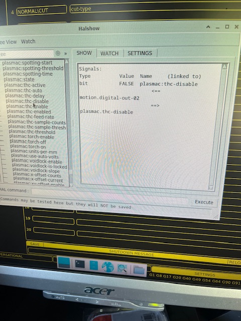

I can figure out why my feed rate percentages and thc on/off isn’t working. Feed rate is just constantly the same and doesn’t change unless I change it manually and thc doesn’t turn off unless I turn it off manually. The g code commands are doing nothing. G code attached bellow. I made a new install media with 9.4 and reinstalled linuxcnc completely just to make sure I wasn’t out of date with anything.

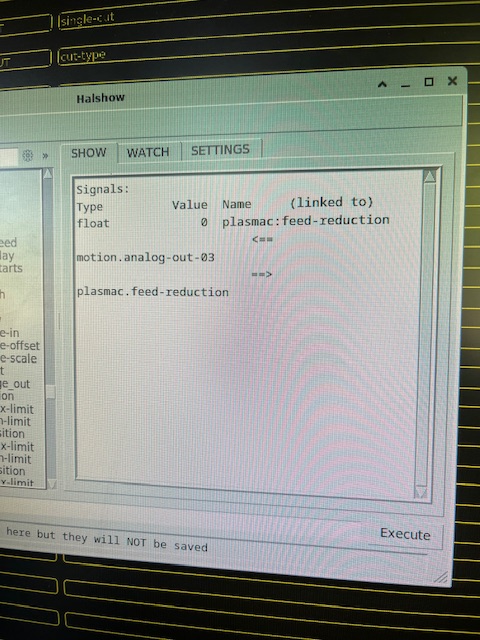

M62 and friends need connections in HAL to have any effect. Do these connections exist? (motion.digital-out-NN etc)

I’m not too familiar with Hal but his is what I could find not sure if I’m even looking in the right spot.

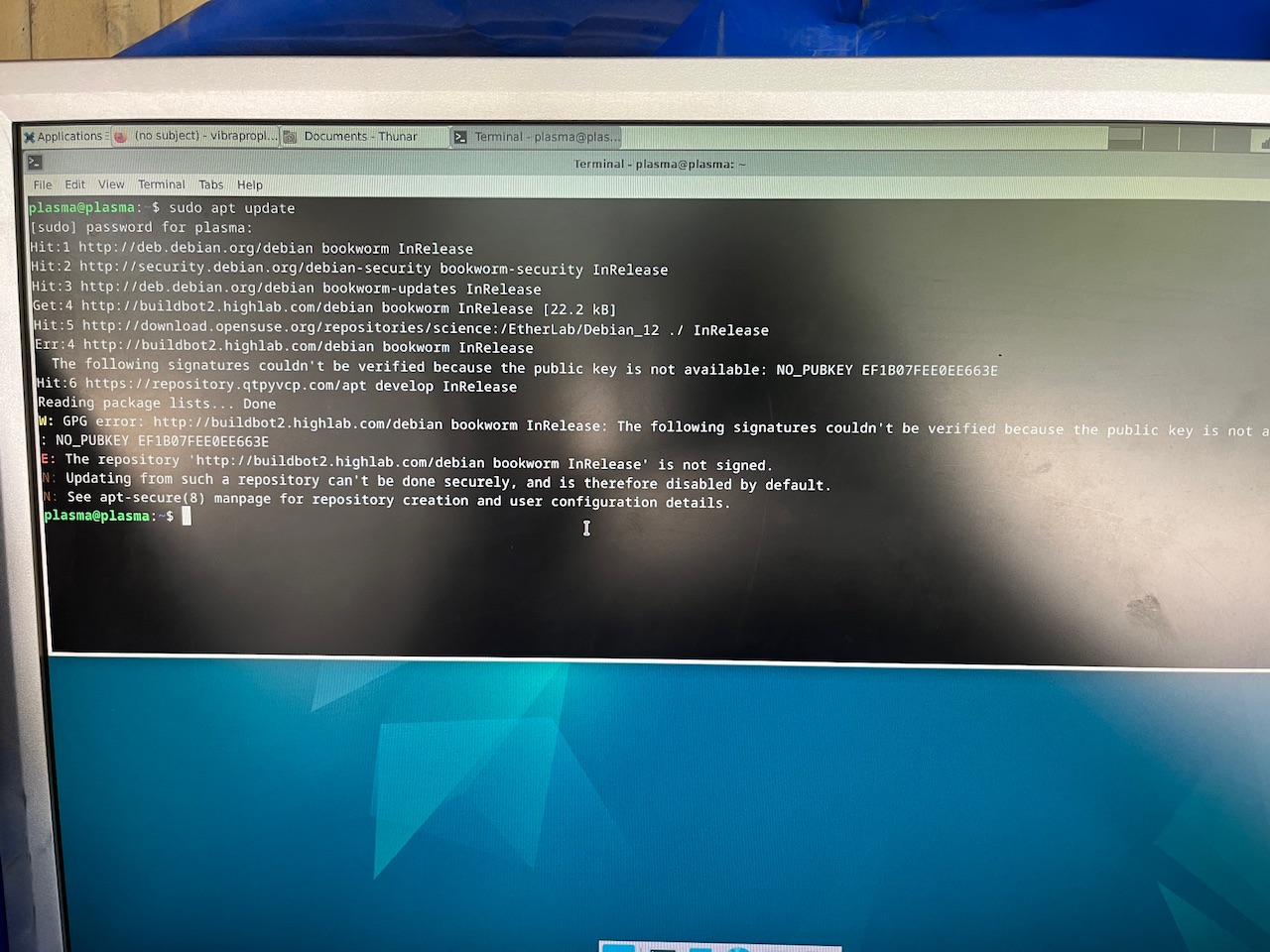

Ok I cannot make any sense of this I have been trying to update to 2.10 for the past few hours thinking that 2.9 might be the root of anll my problems and can’t figure it out. I went into sympathetic package manager then repositories and deleted the two lunixcnc.com lines and refreshed. I then created a new one as follows
buildbot2.highlab.com/debian/
bookworm
master-uspace
then when I enter “sudo apt update” in the terminal it gives me the error I attached bellow. I have read through these post several times, but just end up more confused each time.
www.forum.linuxcnc.org/38-general-linuxc...-do-i-update-to-2-10
forum.linuxcnc.org/9-installing-linuxcnc...ate-from-2-9-to-2-10
Some clarification would be amazing, thank you.

Not exactly sure but i think that is the wrong buildbot, try
buildbot.linuxcnc.org

Doesn’t work. Says “does not have release file”

Buildbot2 is correct, you need to sign it though, as per the instructions on the page:
