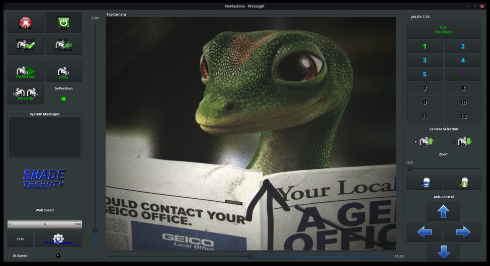

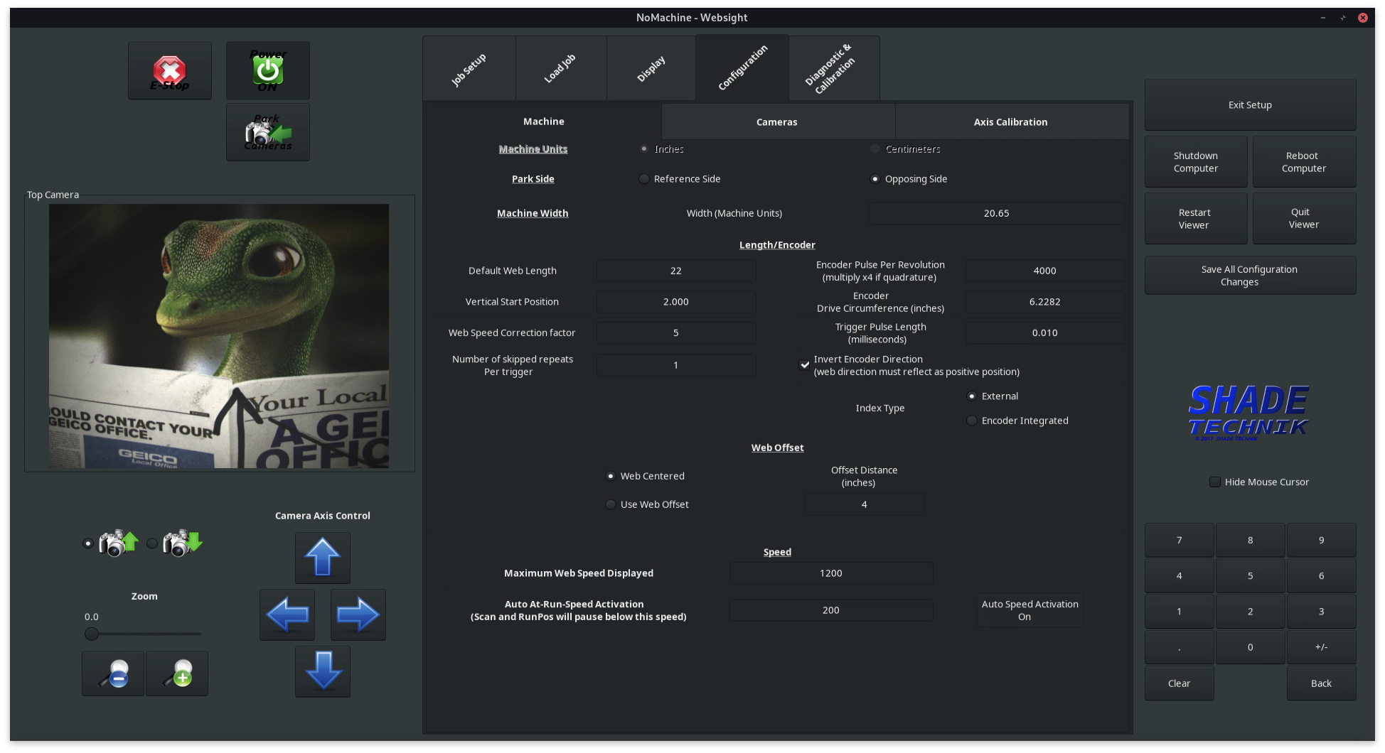

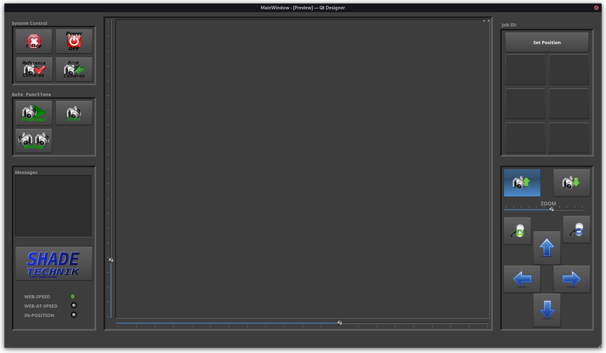

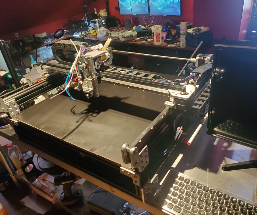

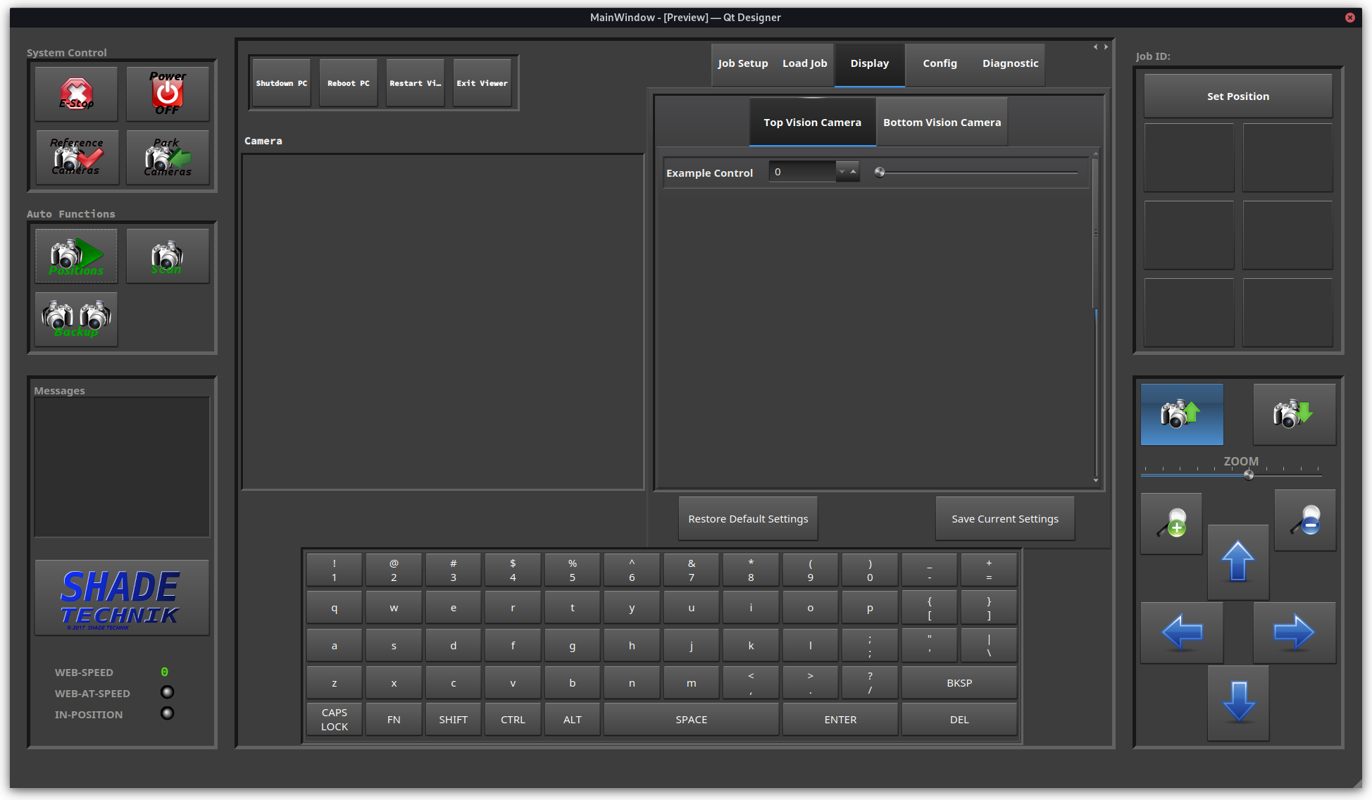

This is my PnP at the moment, still waiting on heads and vacuum pumps but I should be able to get the software stuff started. Maybe at some point I can kit it up and sell it, probably do well against something like a LumenPnP for what that costs. The PC an everything is under the Top platform. It's all belts/steppers so I'm not looking for speed but it's all linear rail so hopefully I can get some good accuracy.I've seen dm17ry's videos, that's damn impressive but that's not going to be easy to replicate even though the configs are online. Honestly I would't touch anything Py2/GTK2 based with a 10ft pole anymore. I have another LCNC machine that's focused on machine vision, nothing to do with PnPs though. Right now I'm going through the painful process of converting the custom GTK2/Py2 UI to Qt/Py3.From This:
To This:
I made the UI's but programming isn't my thing so I've had Python guys helping me which is really the problem with the whole PnP thing. I just need mine to do the thing for me, I don't want to go down some crazy rabbithole of code that I can't deal with personally. It really would be great if someone made a purpose built UI for LinuxCNC for PnPs that was configurable like Gmoccapy.
As for capabilities I usually design my PCBs with a 0402 minimum because I hand assemble them and 0201 really sucks to do by hand. 0402 I can stick with. Feeders I'll worry about down the road. There's a bunch of 3D printed feeder types out there that look capable, but initially I'd probably just do strip feeders and trays or something.
I have a 7i96 laying around since I switched a prototype machine over to a 7i96s but I don't want to use it here, as I don't want to use external drivers. I'm still looking into Remora because all this thing really needs is a 3D printer style controller. Otherwise I'd either make my own controller if I can find a LCNC compatible firmware project or use smaller Mesa card with pin headers and make a Field IO board for it with onboard drivers.
It'd be nice if we could get some kind of unified effort into a pick and place specific LinuxCNC interface. I'd certainly be down to help, but I obviously won't be writing the code for it. I've seen your posts but I haven't really followed it that well since it was a work in progress and being that everyone else uses OpenPnP that's what I planned on doing. What I don't really want to get too into is a bunch of scripts with no documentation that it's really hard to figure out what to do with. Barring a purpose built UI for LCNC, it seems like OpenPnP commanding LCNC via linuxcncrsh is a really good alternative unless some limitations pop up.
