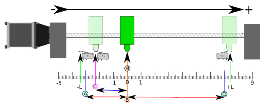

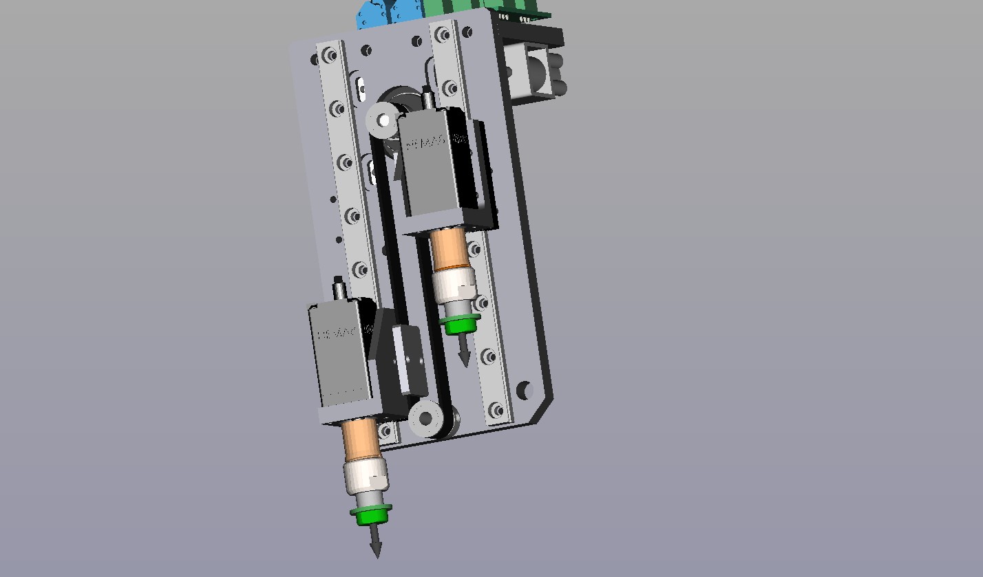

That's not quite what I meant. If you did that then you would have no limit switch unless you add 2 more. I was winging it when I machined my head base, I added 2 threaded holes for inductive proximity switches positioned as limits. I planned on doing what I said first, now I plan on adding the potI think I like your previous idea of having a switch permanently made when the axes is not at home and someway down. That way, you could use two switches (one for each side) and have the centre point where neither switch is made and hence home. So homing would be simply:
- See which switch is made
- Move that side so that it goes up
- Stop when the switch in no longer made
And as long as the switches are at the same height, finding the true centre point wouldn't be too hard, just halve the distance from when the switch on one side releases to when the switch on the other side makes.

Ya wanna explain that process to me? I know how homing and LinuxCNC works but I'd like you to explain the process to me with "1 switch + home offset" so I can explain where it fails and maybe you'll understand.1 switch + home_offset will home it anywhere, including in the middle.
As for precission, it uses a stepper with a pulley directly driving heads, so even a cheap microswitch will be more precise than the drive parts.
Using an optical switch and a 0.9 degree motor seems better for accuracy, as there is no need for a lot of torque, and this is for very small parts.

Two rigid coupled heads, say left side top is home with the switch, then offset to reach the middle.
Cr@p, as i was writing this it occured to me why you insist it is not ok, when homing one of the heads moves down to the botton!
So this is what i was missing.
Ok, then having the home switch stay active for half of the travel and not active for the other half, and setting hal to completely ignore homing switch after homing is complete?
Might need some hal stuff but should be doable, home in one direction if switch is tripper, in the other direction if the switch is opened ?

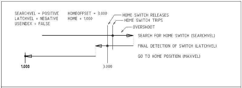

Having read the homing section of the manual, it looks like what we are trying to achieve is standard, i.e. the axis travels in one direction until the switch is made and reverses until the switch releases, exactly what we need
And by what I can gather from this pic
The home switch is ignored after homing anyway, please correct me if I am wrong

Home switch is only valid during the actual homing procedure.
For a setup like the one I pictured several posts back, that's actually pretty easy to do. You just mount an inductive proximity switch on top of the base behind one of the gear racks. The switch will be active about 40% of the range which is probably fine. That is a standard homing procedure, you set it up to travel towards the side that activates the switch, after it makes it backs off. If it's made when homing is started it only travels in the back-off direction.
That only works if you're setup mechanically allows it. Personally I'll be doing something like a 5-turn potentiometer and using the HOME_ABSOLUTE_ENCODER = 2. The nice thing about this is it actually is an "absolute encoder" So it adds closed loop feedback for little coin.
