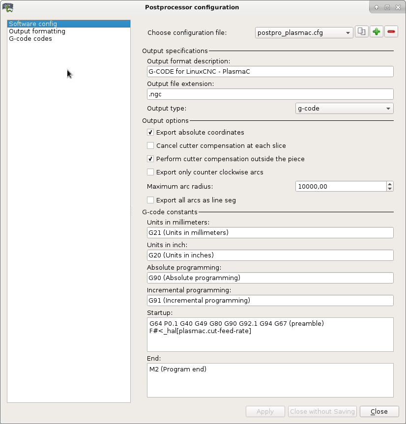

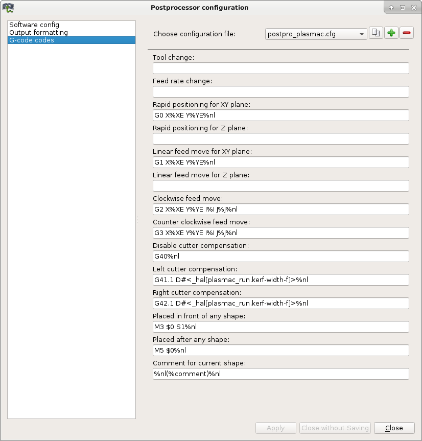

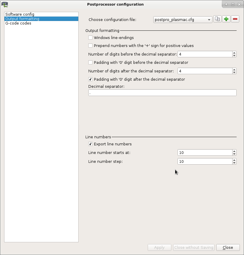

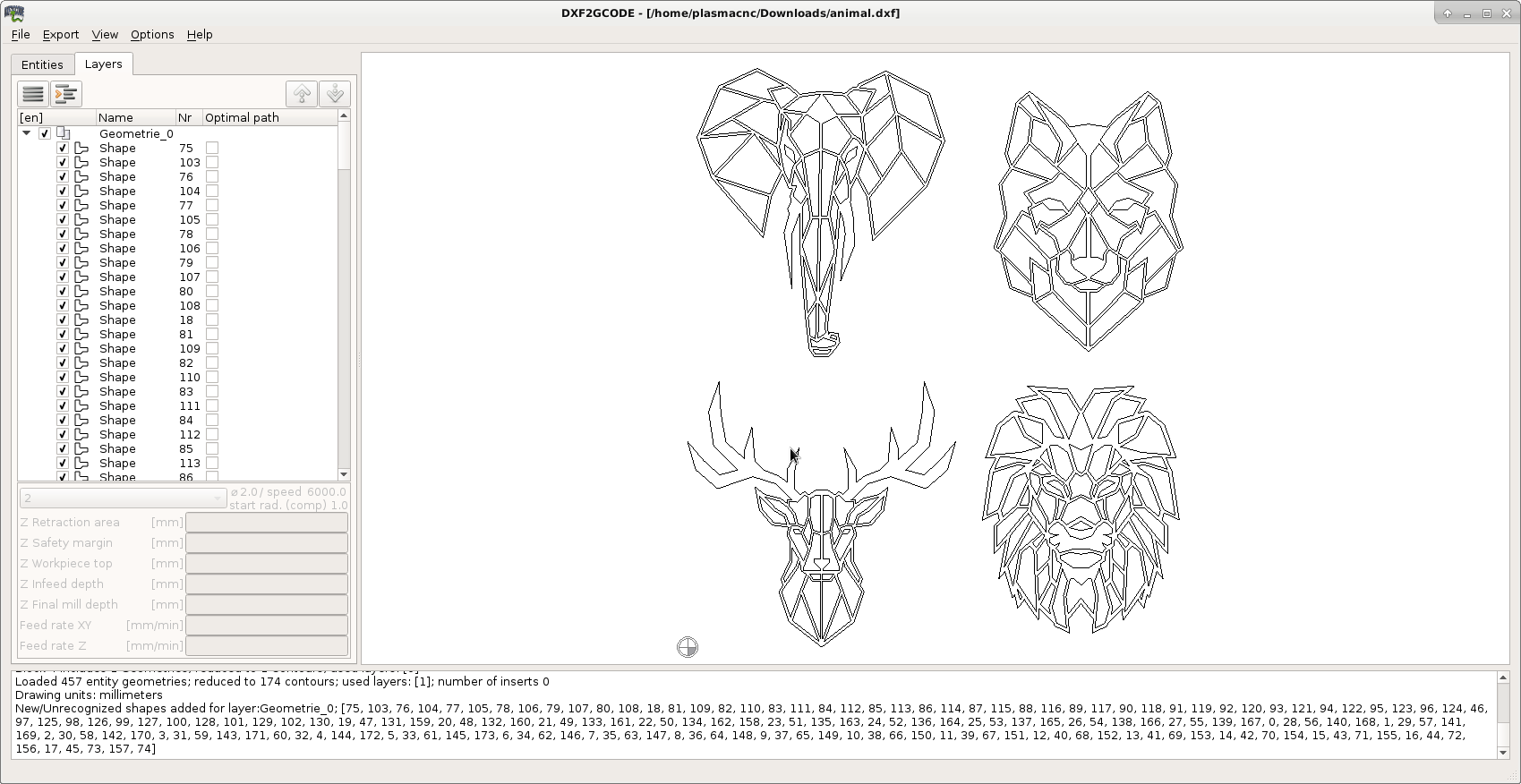

Hey everyone,
Since I have increasingly noticed that there are problems with the installation of dxf2gcode under linux and I also had problems with the installation, I created a step by step installation instructions that worked for me. I performed this installation with a fresh debian 9 installation (virtualbox installation).
I cannot guarantee the functionality or damage to the system.
You use the installation guide at your own risk. Make a system backup before you start the installation!
So let´s start (copy-paste each row into terminal):
Normaly it should work.
Also attached screenshots of the pp config for plasmac.
Have fun!
su -l
enter "root passwd"
apt-get update
apt-get upgrade
apt-get install python3-pip
apt install python3-pyqt5
apt-get install python3-opengl
apt-get install qttools5-dev-tools
apt-get install pyqt5-dev-tools
apt-get install pstoedit
apt-get install python3-configobj
apt-get install libpcap-dev libpq-dev
pip3 install --upgrade setuptools
cd /tmp
wget https://sourceforge.net/projects/dxf2gcode/files/dxf2gcode-20191025.zip
cd "go to folder where you want to install dxf2gcode"
unzip /tmp/dxf2gcode-20191025.zip
mv ./dxf2gcode-20191025 ./dxf2gcode
cd ./dxf2gcode
./make_tr.py
./make_py_uic.py
python3 ./st-setup.py build
cd ..
chown -R "user:user" ./dxf2gcode/
python3 dxf2gcode.pyNormaly it should work.
Have fun!

- hermann1976
- Posts: 67
- Thank you received: 17
26 Dec 2020 11:48 #193220
by hermann1976
Replied by hermann1976 on topic How to install dxf2gcode
Hello and Merry Christmas to all!
I'm sorry that I caused confusion with the G67 command in my description of the configuration of the post processor from dxf2gcode:
I suspect that this G command was part of the template from the standard postprocessor of dxfgcode. Unfortunately, I don't know exactly anymore.
The entry in the "Startup" field should look like this:
G64 P0.1 G40 G49 G80 G92.1 G94 (preamble)
F#<_hal[plasmac.cut-feed-rate]>
The parameter value of G64 could also be specified smaller - for example G64 P0.05
Please also remove the G90 command from the preamble line. This entry comes from the "Absolute programming" field.
Thank you.
Thank you.
