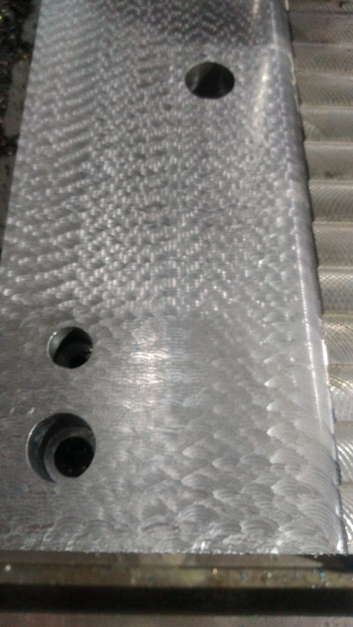

Hello friends, I apologize for the beginner's questions ... I work with CNC for more than 20 years with Retrofiting and LinuxCNC I am just one ... I have a machine that is not leaving a beautiful finish, on the contrary, when it will make the top o finish looks awful. I already tried to change the PID of the controller of the servo drives and I was not very successful, it improved more but it didn’t solve it. I'm suspecting that it's post processing and I don't know anything about it, I know that the client uses WORKNC, someone could help. Thank you very much

That looks quite pretty, but I guess it is not what was wanted.
Are the spindle bearings in good condition?
It could be the Z axis PID. If you use Halscope to look at the Z axis position feedback and PID error do you see a cyclic oscillation?

Hello andypugh, so it's really ugly, the bearings have been replaced with new ones. I worked on the PID, but it may not be good, I didn't notice any changes, for better or worse. I don't know how to use Halscope, I need to learn ....

Thanks for the help, I managed to solve. There were two situations, the first was the Z-axis drive parameter, I increased it proportionally until the motor started to resonate, then I decreased 30% of the value, it was very good. And in interpolation it generated a little mark in the axis reversal and I managed to solve it using G64 P0.002, before I was using G64 P0.02.... The machine is fine Bia machining molds of automotive dies.
