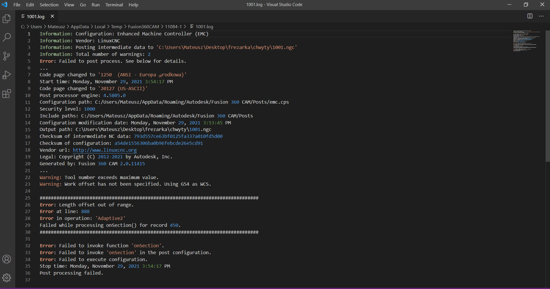

Witam mam problem z PostProcesorem W fusion 360 po Aktualizacji (wczesniej działa wszystko) na Linux CNC gdy wybieram linuxa z listy wyskakuje BŁĄD i nie mogę wygenerować G-kodu.
Posiadam ploter frezujący samoróbkę nie wiem co to może być ktoś ktoś jaki pomysł ???

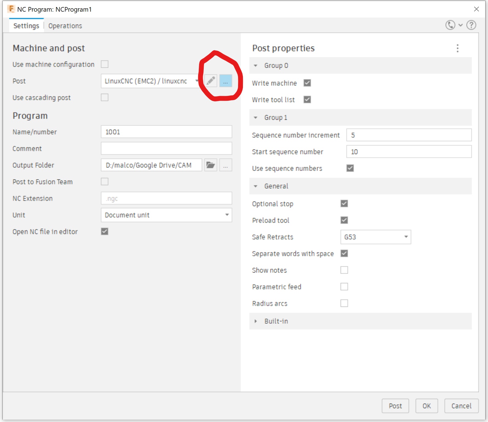

Fusion 360 has 3 different post processors for Linuxcnc. After the update I had to go back and download one again and seems to work fine.
Make sure you have an updated post from here:
cam.autodesk.com/hsmposts
Can change the post used this way:

03 Dec 2021 16:16 #228302
by Michael
Replied by Michael on topic Postprocessor Fusion 360
Try posting the code without operation Adaptive2 and any other operation that use that same tool. Looks like you have some had settings for that tool offset and numbering. See if the code works without it.
